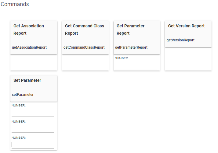

If you have a newer ZEN24, you should be able to switch to the fast ramp rate. Look in the manual and if it shows Parameter 4 (Ramp Rate Control) as an option, you can change it to turn on/off quicker (within a second).
Will do thanks!
Yes that did the trick - Thank you!!! Have to say the 14 or so Zooz switches I've put in for our upstairs renovation have been working really well so far.
Note: I used @mike.maxwell's simple zwave tool driver to set the parameter..
Parameter: 4
Value: 1
how you know it was that way? my tool just show number 3 times in parameter
I dunno - I just replaced the z-wave driver with the z-wave driver tool and set the parameter based on @agnes.zooz recommendation. I searched and found this info for Zen22 so decided to run with it:
Parm Size Description Value
1 1 Invert Switch 0 (Default)-Upper paddle turns light on, 1-Lower paddle turns light on
2 1 LED Indicator 0 (Default)-LED is on when light is OFF, 1-LED is on when light is ON
3 1 LED Disable 0 (Default)-LED is on based on parameter 2, 1-LED is off always
4 1 Fast Ramp 0 (Default)-100% brightness within 2 seconds and off in 4 seconds, 1-instant 100% and off in 1 second
From here:
It seemed to work.. Since I only recently bought the switches my assumption was that they are of the newer variety.
but your tool shows like this? for some reason the dimmer is not getting the setting 4 1 1
