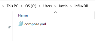

I could use some help setting up InfluxDB via Docker Compose. I'm following this guide.
I have an influxDB folder created in my windows home directory (C:\Users\Justin). I also have three files in the home directory
In the influxDB directory, i have put the compose.yaml file exactly as they have it.
But I'm getting this error when running the compose command:
Not sure what to do with that. Help? (I don't know much at all about Docker....)
The thing that is suspicious to me is " error mounting "/run/desktop/mnt/host/c/Users/Justin/.env.influxdb2-admin-password" to rootfs" since that's not a valid path. How do I change it to where it goes for c/Users/Justin/.env.influxdb2-admin-password instead of starting with /run/desktop/mnt/host
(in case it matters, I already have a Docker container running an Obico server for my 3d printer)
I would just get rid of all that extra garbage and just put your admin username and password right into the compose file. Leave the token blank and it will generate one, unless you really want to make your own. After the container is up you could remove that stuff from the compose file as it will be saved within the database.
I am not sure if the "org" and "bucket" are required, otherwise it may just ask you when you log in the first time, thats how I have always done it.
I actually think you could just skip the entire "environment" section and just fire it up blank. If I remember correctly there is a web setup that walks you through it the first time if not setup already.

Ok that worked to get an instance up and running. :+1: When I enter the credentials into the web UI, though, it logs user unauthorized. Not sure what to do about that
If you tried it with setting the user/pass in the compose file, try blowing the container away and them removing the environment section totally and then start it up again. I suspect it will walk you through the setup when you first go to the web UI.
Hm. Didn't seem to start any setup in the web UI. Still just the login screen. In the log it says "msg=Unauthorized log_id=0rOpmiqW000 error="token required""
I've also tried the apparent default credentials of Administrator and Administrator1. (or Administrator1). But no luck. Sheesh.
One potential red flag is that there are no files created in my influxDB folder. But obviously something is running right because I get the UI when I go to the URL at port 8086. And Docker Desktop shows a container running.
