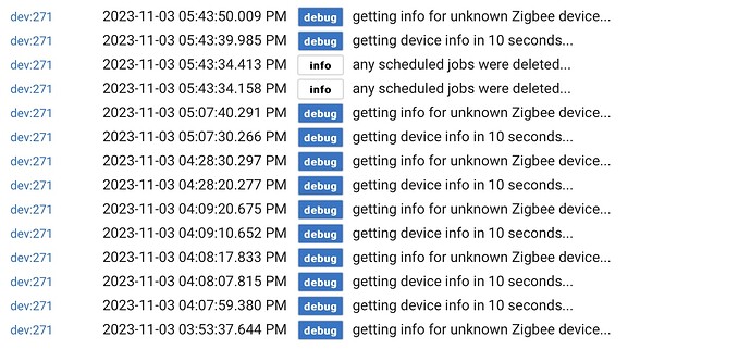

Still no luck with the blind. Could be it just won’t update the firmware, Really don’t want to try another blind.
This is the procedure I followed MANY times
Left the log running for hours. Looked for something from the hub and saw only this
Note the last entry was around 11am
Here is the log for the blind
Note the times are starting around 4pm with no corresponding time for the hub.
One thing that might help - Step 5 when I click Get Info there is nothing in the log.
The blind might be sleeping. Maybe try using the manual buttons on the side of the blind to move it a bit, and try updating while it's moving? Longshot, just an idea.
