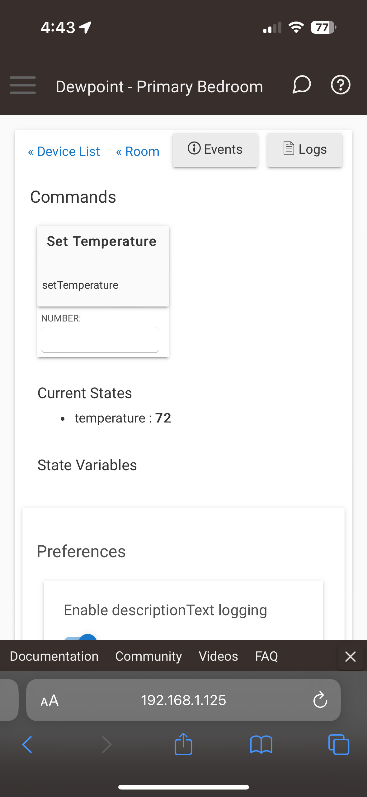

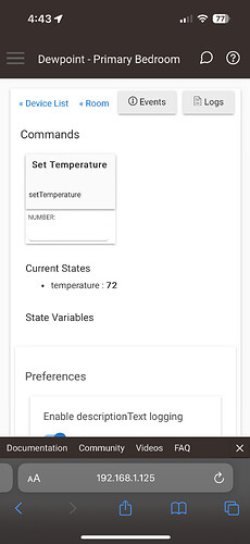

To be clear, the Hubitat virtual temperature device temperature current state doesn't agree with the Home app device, when viewed through the Home app on an Apple iPhone/iPad?
Nope even the device in Hubitat appears to be stuck and not updating every 5 min as listed in the dropdown. I have 3 sensors and none of them have changed it turns out since creation. I tried remaking and same result.

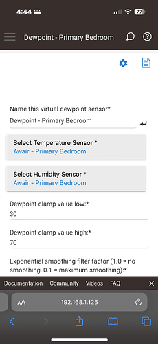

Ok I will investigate. Can you take a screenshot of the app configuration web page and post here?
App page for one example below! I’ll post device page on the next reply.

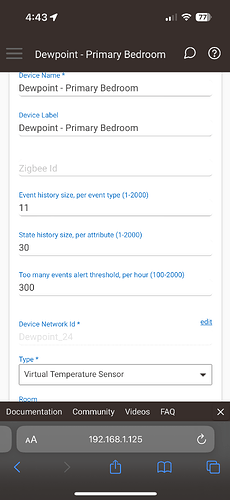

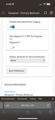

Device page for same sensor.

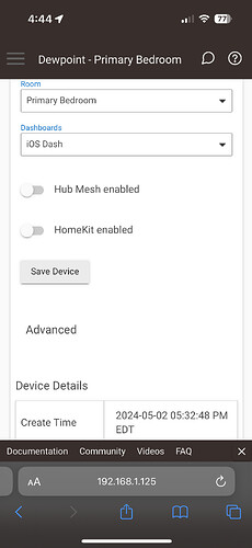

Also I noticed from the screenshots that the virtual temperature device was not added to the Hubitat HomeKit app (HomeKit Enabled radio button not set), You will want to do that to then add/view the device in the IOS Home app.
