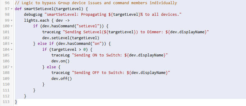

So I've been experimenting with AI writing my own custom app to control lights and I'm having issues with it controlling mixed light groups with switches and dimmers. I tell it that it's not controlling the dimmer and it revises the code to control each member of the group individually which makes sense. Can someone tell me why the below is not controlling the dimmer. I've added tracing, etc and still it never logs that it is setting the dimmer.

I’ve been using Google AI and yes it is quite an iterative process. When the dimmer wasn’t working I explained that the group contained switches and dimmers so it modified the code as seen and added the comment you see. As a software guy myself it “seems” like it’s trying but logs never show it recognize the dimmer havein the setLevel capability and thus never sets the dimmer. I could try other AI but just wanted to get a groovy expert to comment why this should work or not. I just need to provide the right prompt to google AI.

That looks like it should work. Is traceLog() a method that exists somewhere? You could just do log.trace if you wanted to see for testing/development, without relying on having this method defined or any checks that might happen there, then remove it when you know what's happening when.

I also just did a bit more investigation and change the lights from the group to just the dimmer and it set the dim level on the dimmer as desired and the log showed it doing so. Setting the lights back to the group of lights that contain that dimmer does NOT affect the dim level. The trace shows "My Office Lights: smartSetLevel: Propagating 20% to all devices." but there is no "setLevel(20, 0)" for the dimmer in the group. So it is not test the commands available for each device in the group from what I can tell.

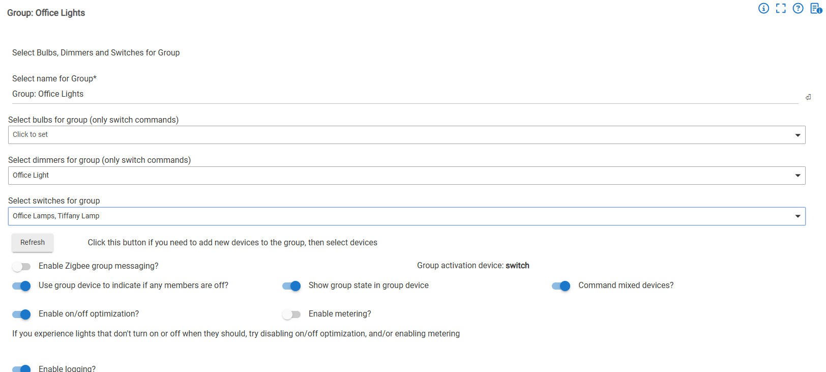

I have tested the app with choosing the devices within my group and it works as one would expect, This is the group I originally selected...
I note this " Group activation device: switch" However, using RM to generate the automation seems to work.

The code that sends setLevel() to the device (and that logs that you are about to do so) is guarded by a check for whether the "setLevel" command exists -- line 100 in your screenshot above. A switch-only device won't have this command. A way you can verify this is by looking at the device detail page for your group device: you'll see commands/buttons like "On" and "Off" but not "Set Level." Your app is working as written.
If you want the group device to be able to control level as well, you'll have to create a new group (this can't be changed after the group is created), then use that device in your app instead. Of course, you'll need to make sure that all the devices in your group can work this way or use the appropriate options in the Group app to make them work how you want. (It might also be good to explain what you do want since it's not clear what your app does and maybe there's a way you can do this without that, but this is what's happening with your app and why, at least.)

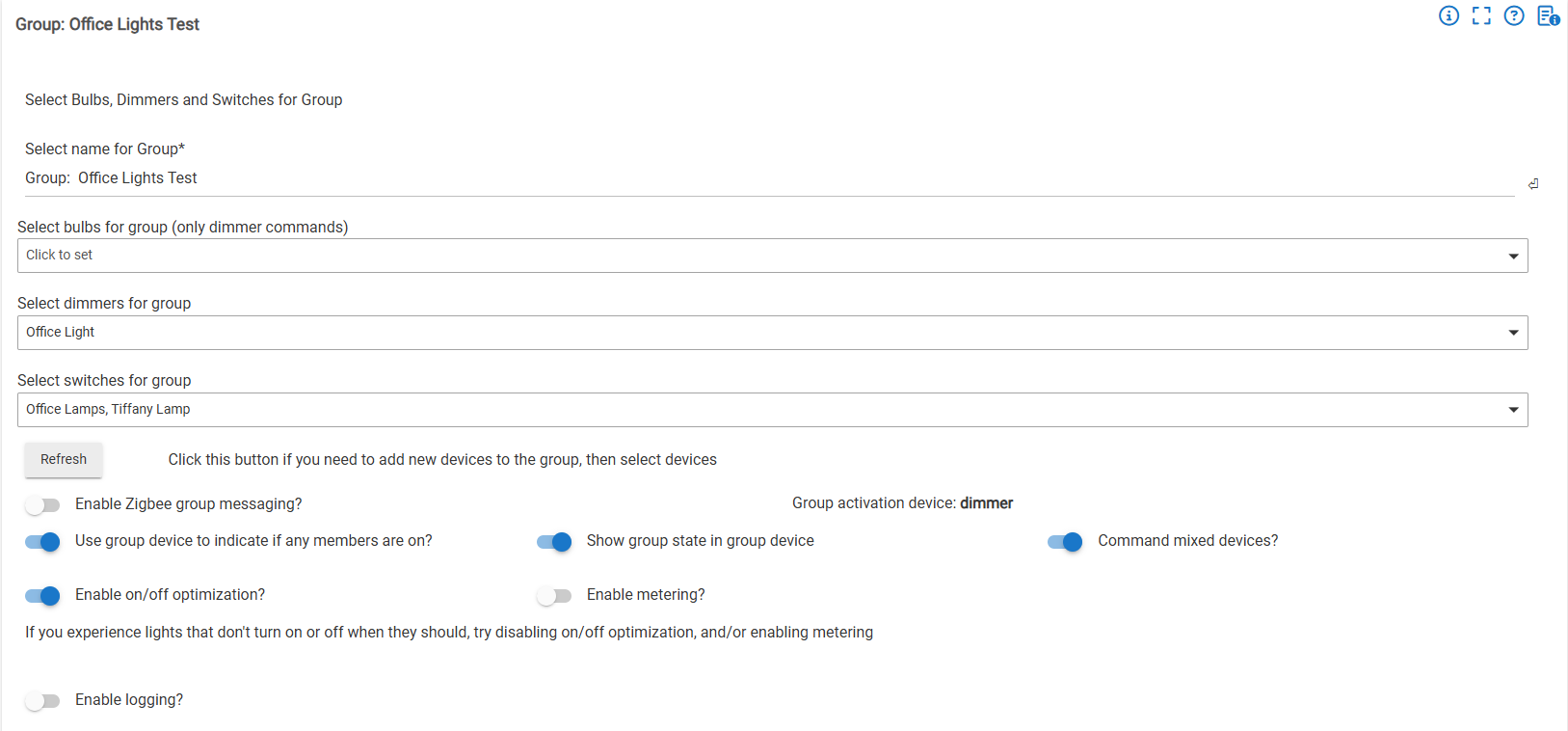

Yes, that was what I was thinking that the group only acted as a switch and therefore did not support the setLevel command. I just needed verification. I created these groups so long ago I didn't realize that you can create the group as a dimmer or switch etc. I see that now based on your excellent guidance. I recreated the same group with group activation device: Dimmer. It's interesting you cannot change that after the group is created, but I am sure there's some reason.
It works as expected now. This probably explains a lot of grief I've had with the behavior of groups with mixed devices in them. Arg. Lots of replacing to do now. Thanks
