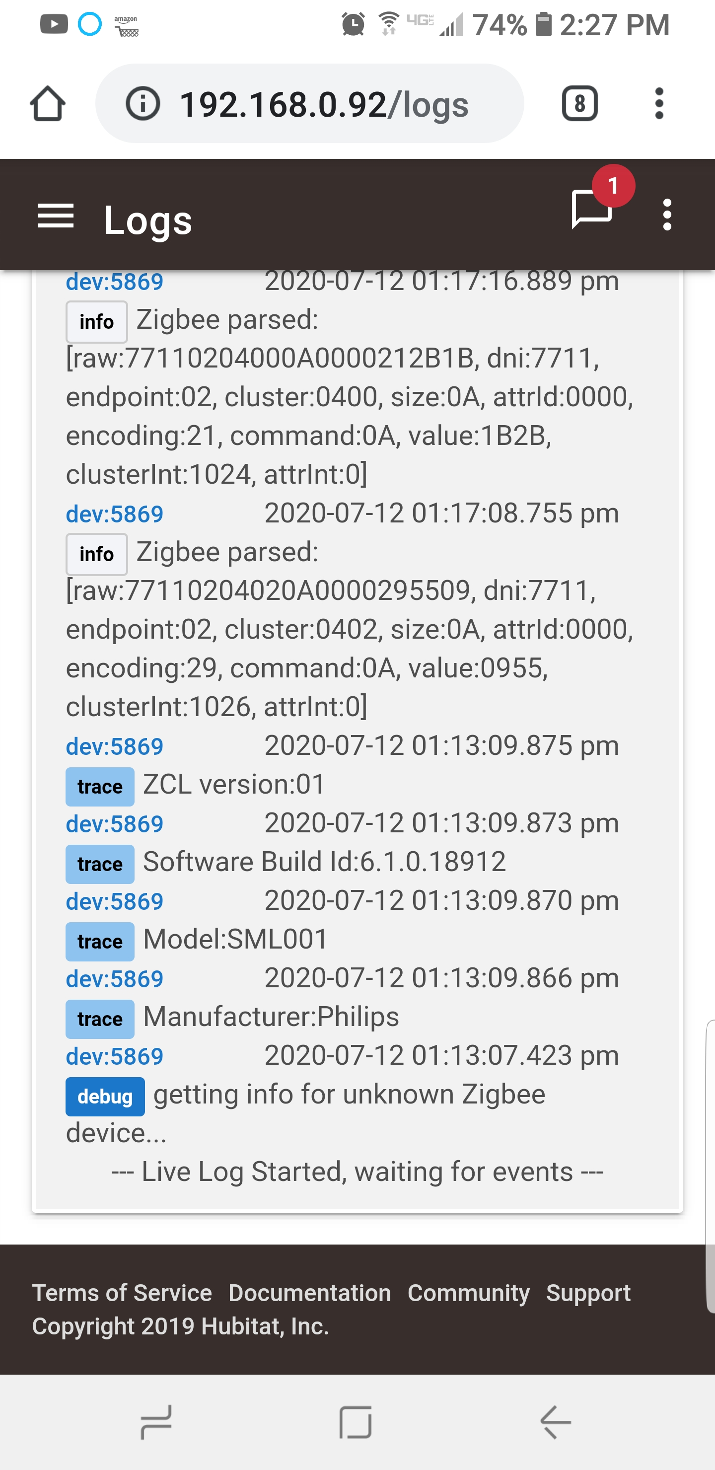

NOTE: since i think this is relevant, I'm reposting here my experience with hue motion sensors and their effect on my mesh. It was originally posted in another thread
Okay, so without this ghost feature I would have never discovered- That my hue motion sensors, I love so much, are really messing up my mesh.
Constantly having ghost devices be found by the HE feature for ghost zigbee devices. And was finally able to track down to Hue motion sensors. Similar to the great peanut panic, these hue motion sensors are jumping around like crazy and constantly switching their 16 bit address, and those ghosts are found by Mike's feature(i haven't upgraded yet to remove feature)
About 2 weeks ago I added the 16bit address to each of my 4 hue motion sensor's names. ALL except 1 hue motion sensor have changed their 16 bit address, and therein is the cause of my ghosts.
When I hit "get info" on my ghost,I see this below.
not sure if this a bad thing or something that would clear up on it's own? And is it a feature of hue or a bug?
