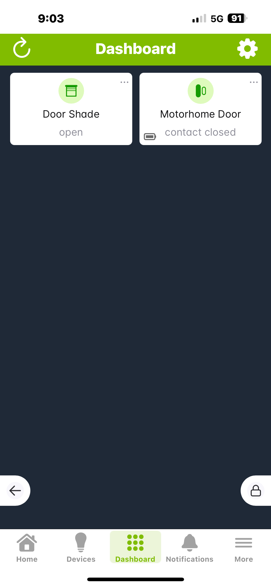

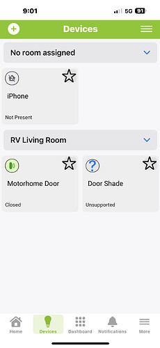

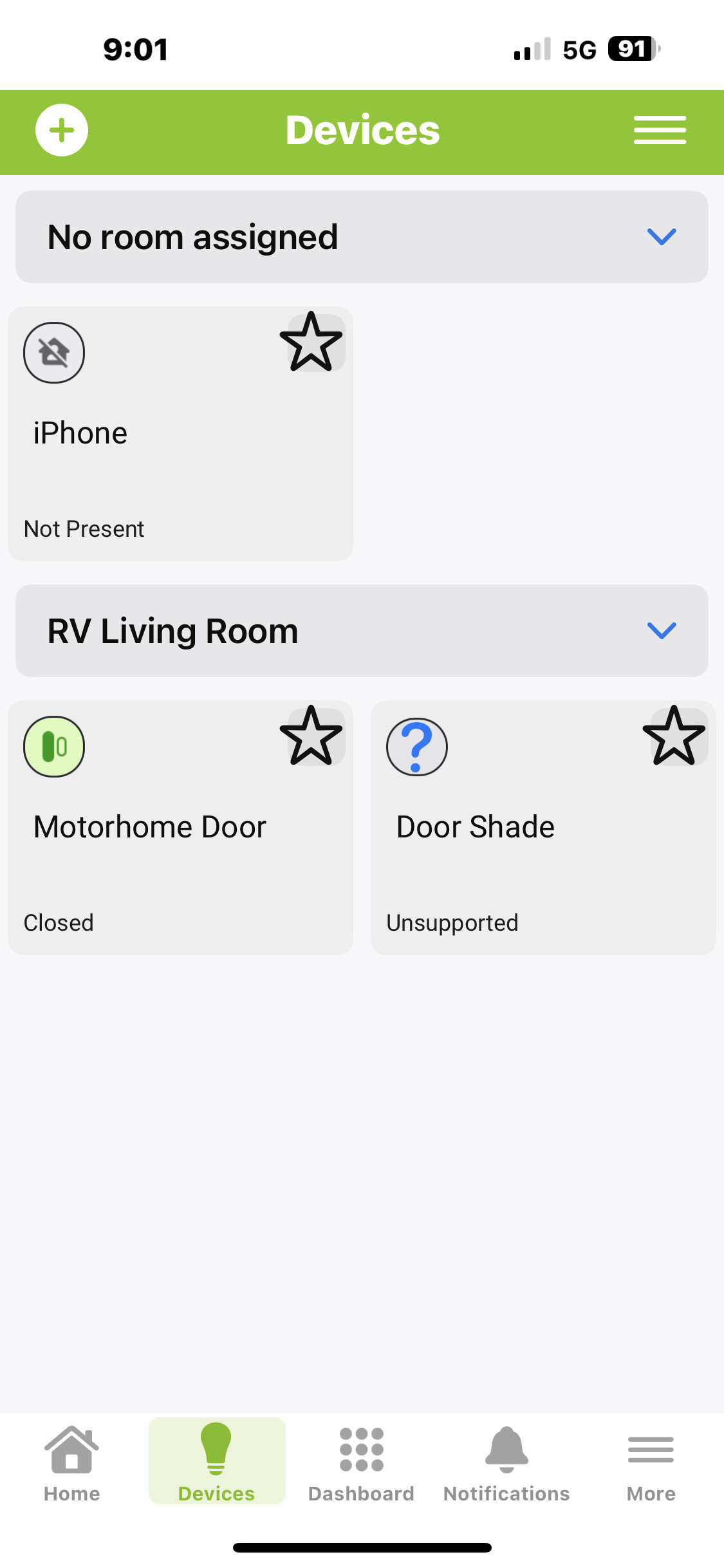

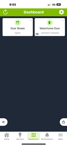

  3. Here is the problem:on the dashboard the icon for the shade is fully functional but under the device tab the shade appears but indicates that it is not supported. The other issue is that when I attempt to link the shade to the alexa using the Hubitat Alexa app and the Alexa skill; the shade does not appear so I can not control it via a voice routine.

The shade is supported just not in ez-dash. If you put it into classic dash it will work fine. Is it using a built in driver or custom driver?
