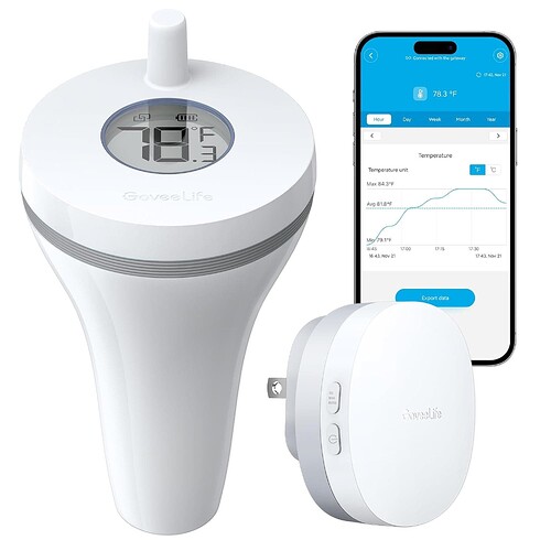

Just posting this in case anyone else is interested in how I am able to capture temps from this device. I got it on Amazon for $25 so it was too good to pass up.
I was hoping it would be supported with one of the current Govee apps on HPM but it doesn't appear to be supported by Govee's developer API.
Instead I wrote (with a major assist from Claude) a custom driver which logs into govee to fetch temp data from this device.

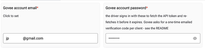

  • add new device -> virtual device -> Govee Pool
Login:
  • find the new device in devices list
  • enter govee email / password and hit Save
  • click on Login
  • you should get a code from Govee. Enter it into the submit login code field and hit Run button

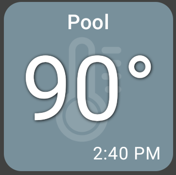

dashboard display with HD+
