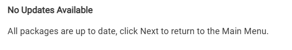

I just ran an "Update" in HPM and it reported nothing to update. So maybe HPM is still updating itself, or ?
This is the version info the integration shows at this point:
The changes are in the Library files and not in the main app. You would need to do a repair to refresh those files.

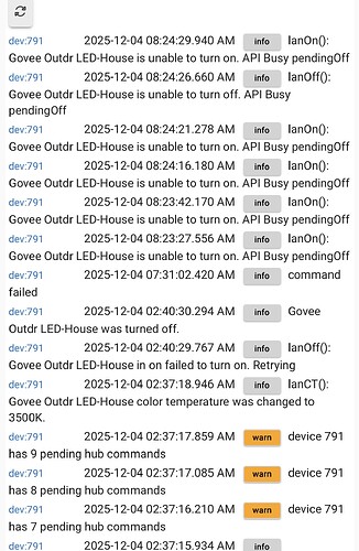

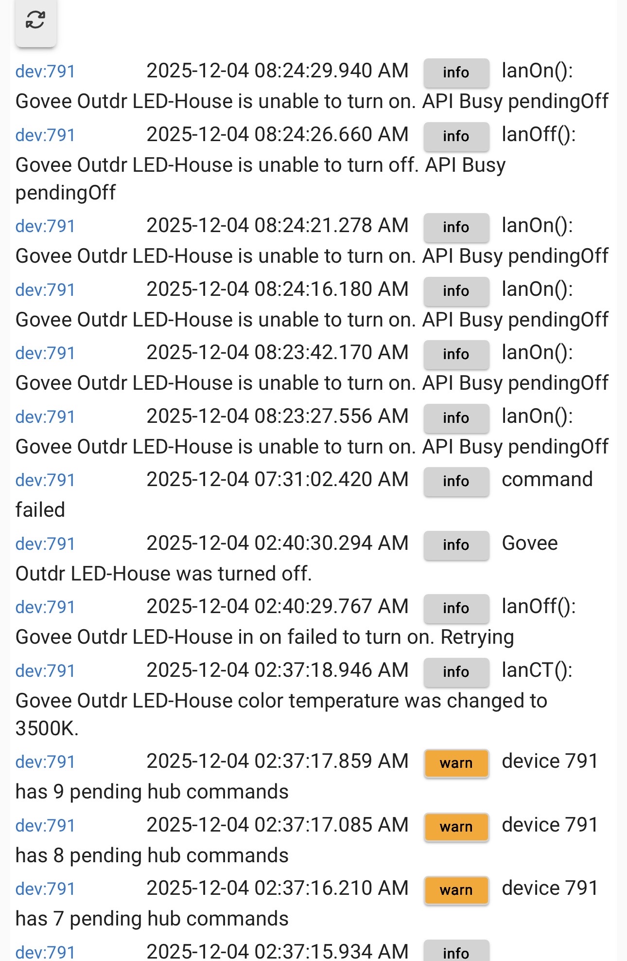

Lights were not responding this am after the HPM repair last night.
Motion routine at 2:40 am (on and color temp via LAN control) worked fine.
However at 7:30 am the call to load an effect did not work, and I suspect the driver was stuck after that. I have lan control on, but not local scene LAN.
