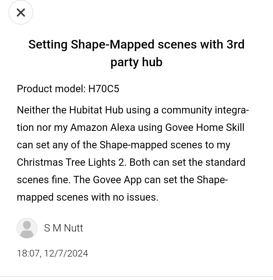

Correct! It does not work using an HTTP POST using Postman directly to the API nor using the Alexa Govee Skill. Using those methods, I can change to the simpler scenes just fine but not the shape-mapped ones.
EDIT
My message to Govee thru app:

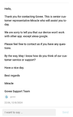

And their response:
I don't know if it's related, but the "Like device" groups in the Govee app can only use local BT to connect to the lights, which just seems dumb for a "cloud" app. It's frustrating AF to not have more control over the sequencing and synchronization of the light sets. For "smart" lights, it sure is dumb.

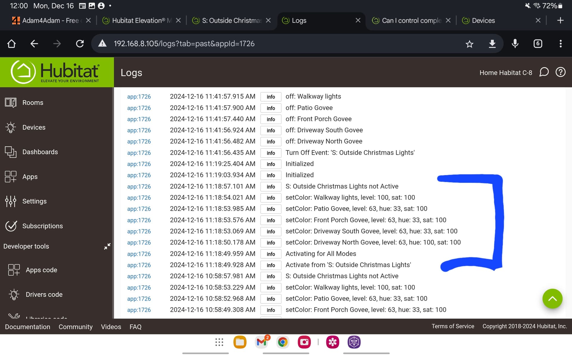

So, I'm encountering a weird issue, and honestly, I can't tell if it's a Govee Integration V2, a Room Lighting issue, or just an internal brain fart of some sort.
I have Govee lights (H7075) working within habitat. I can change colors, adjust brightness, and etc. via the device page with no issues...
But, it seems like when I put them into Room Lighting app, it seems to not take the "Level" setting, and always sets the level to 100...

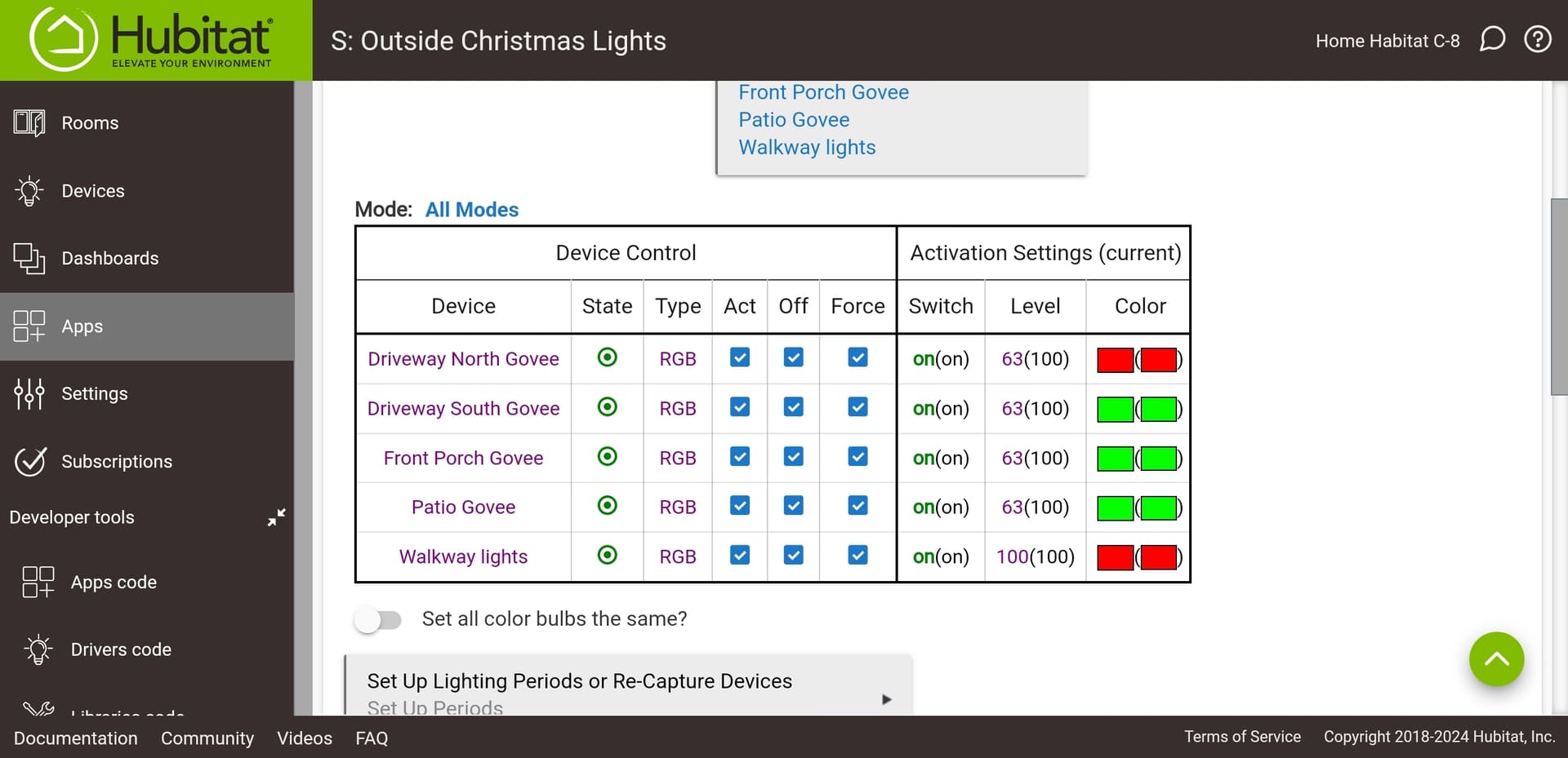

The RL table is set to:
And when I activate the RL app, the logs would indicate that the level sent was 63:
But as the able shows, the lights are set to level 100, not level 63.
Any ideas where the problem might be (include me being the problem... LOL)
This actually does make sense.
The cause of this is the fact that the Govee API uses RGB while Hubitat uses HSL or Hue, Saturation, level. Depending on what i researched Level didn't always mean brightness.
Either way when you select a color with a color picker and it is converted to RGB and the brightness is already accounted for in the RGB value. So to prevent the brightness from being applied twice the driver sets the brightness value of the device to 100 it does sound a little off but it.
I guess I could change the driver to always use a level value of 100 when doing the conversion and then set the brightness value after, but would need to test it. That would atleast give the expected brightness value
Either way the conversion back and forth between RGB and HSL isn't perfectly smooth

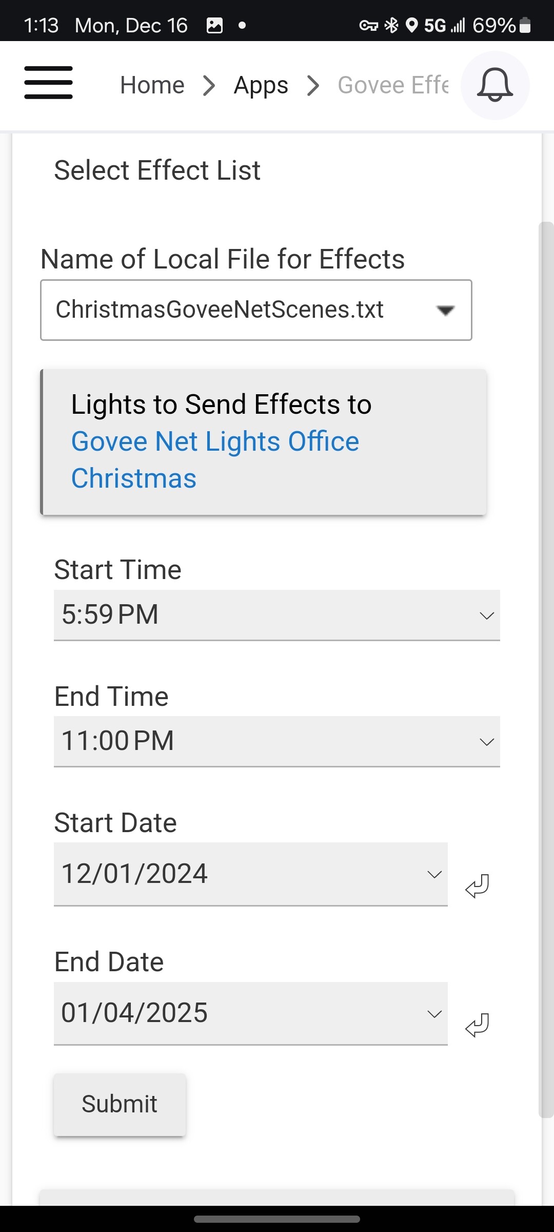

This may be a little rough....
https://raw.githubusercontent.com/thebearmay/hubitat/refs/heads/main/apps/gEffects.groovy
Looks for a text file in the File Manager as input. Format is similar to what you had above, but without quotes. Third field is the number minutes to pause between records (if omitted defaults to 5).
12529:Christmas Tree:5
12530:Christmas Bell:5

Just playing with it while my wife is in a store looking at stuff... Very cool! One thing I think would be nice in the future is the ability to have themselves automation start up\stop based on a switch turning on\off.
One thing I noticed is that the time setting prompt kept popping up even before I tapped on any of the time setting fields.
