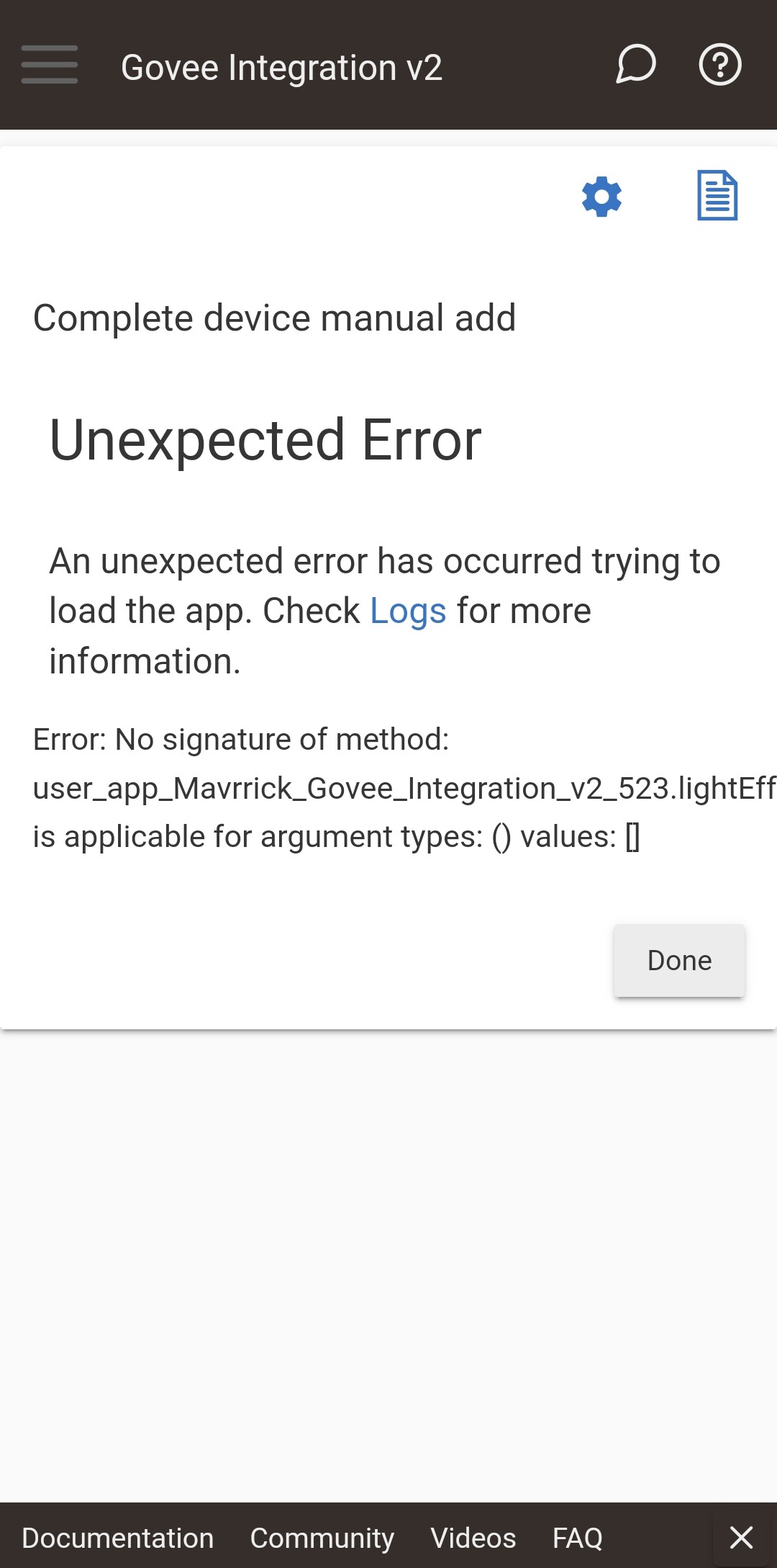

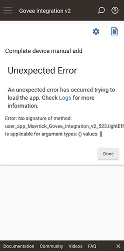

If I add to the LAN integration, I get this here:

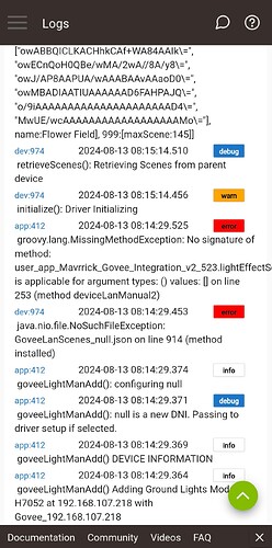

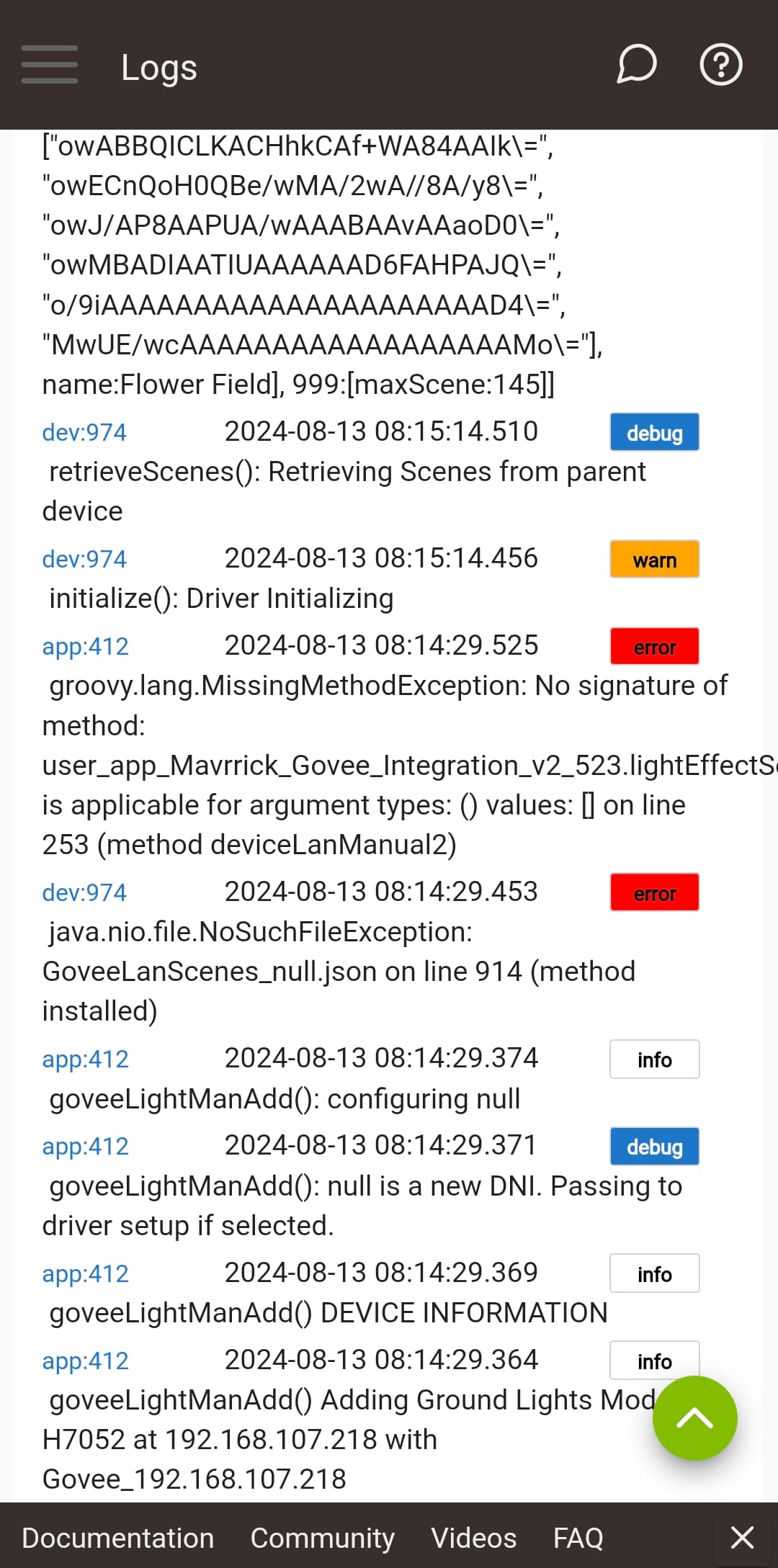

There are errors in logs when adding:
However the device does show up but it never updates when the actual device turns on and off. If I hit refresh, this error shows up in the logs:

I will look into that error, but if the device created then it likely isn't a issue. This may be something i need to look at addressing as it was likely introduced with the recent rework of the Manual Lan Driver. I think this is related to scenes based on the errors, and that kind of makes sense as I believe the Lan Only devices use a different naming for the files they use. I am working on adding some info on this into my documentation for the Govee Integration app now.
It should update when changed within Hubitat. Is that not happening? The status of devices that are LAN only are only updated by changes initiated from within hubitat. There is a limitation on Hubitat that prevents me from creating the UDP Listener that the API supports. So that driver will change states when they are changed from within Hubitat, but will not retrieve states from anywhere. If this ever changes I will add in the ability to retrieve the state from that listener.
I really should remove the option for running a refresh. That is oversight on my part.
