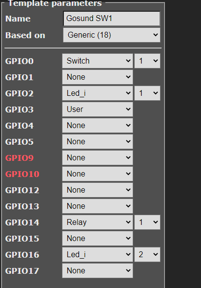

So I flashed my Gosund SW1 with Tasmota 9.3.1. Everything looks good, it works with Hubitat perfectly fine. The only problem I have is the LED. I'd like to have green indicator turned on once the switch is ON and red once it's OFF (or the other way around). I've tried different combinations in the template but I was able to make only the red indicator LED working and showing the status or only the green one. Is there any way to make them coexist?
Here is my current template:
{"NAME":"Gosund SW1","GPIO":[160,0,320,1,0,0,0,0,0,0,224,0,321,0],"FLAG":0,"BASE":18}
