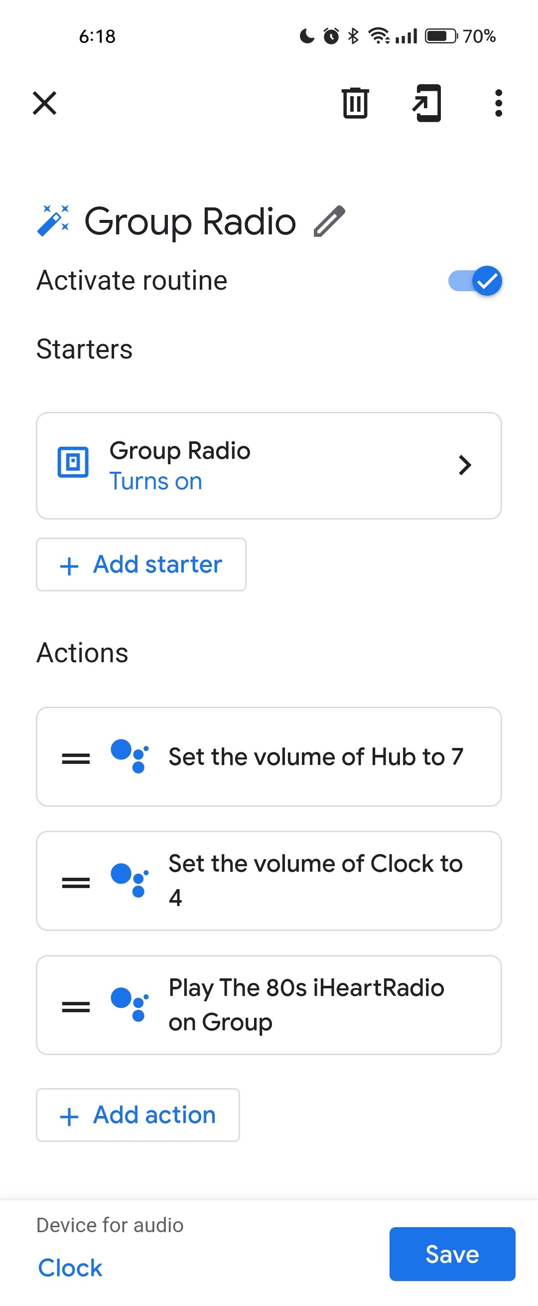

Google Home now allows Household routines to be triggered by certain Hubitat devices. For music and timers I find it easier to let Google do the heavy lifting.
To accomplish this you create virtual switches in Hubitat and then link them to Google Home (Google Home > Settings > Works with Google). Those switches can then be used in various Hubitat rules and can be set as the triggers for Google Home routines.

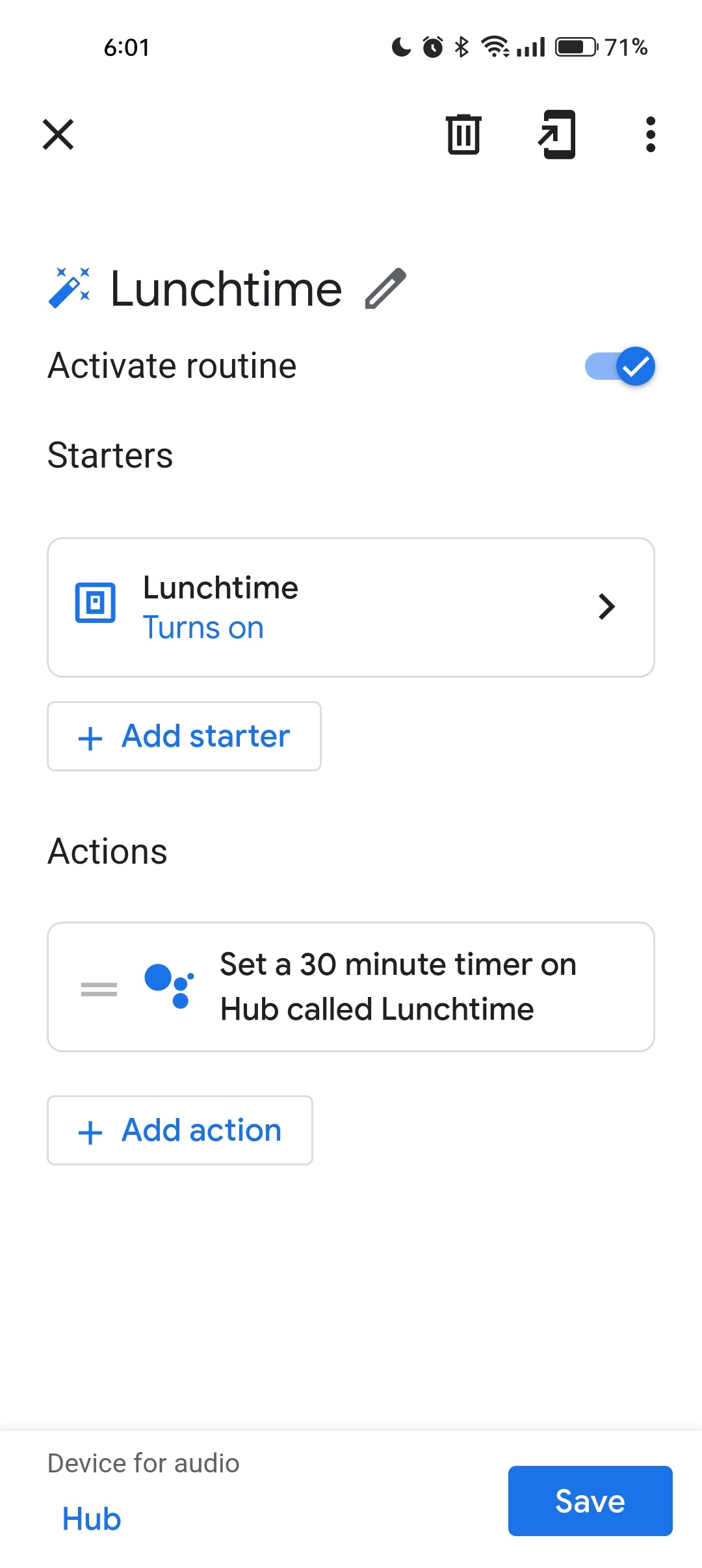

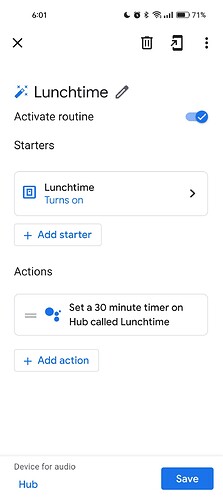

Example:
I created a virtual switch in Hubitat called Lunchtime which is switched on via Rule Machine when I arrive home between certain times on a workday.
Then I linked the switch to Google Home and set it as the trigger for a household routine called Lunchtime (does not work in personal routines, only household).

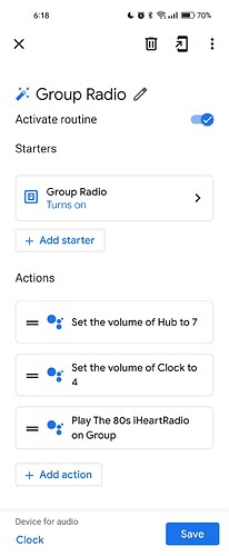

For Radio I have the following routine
