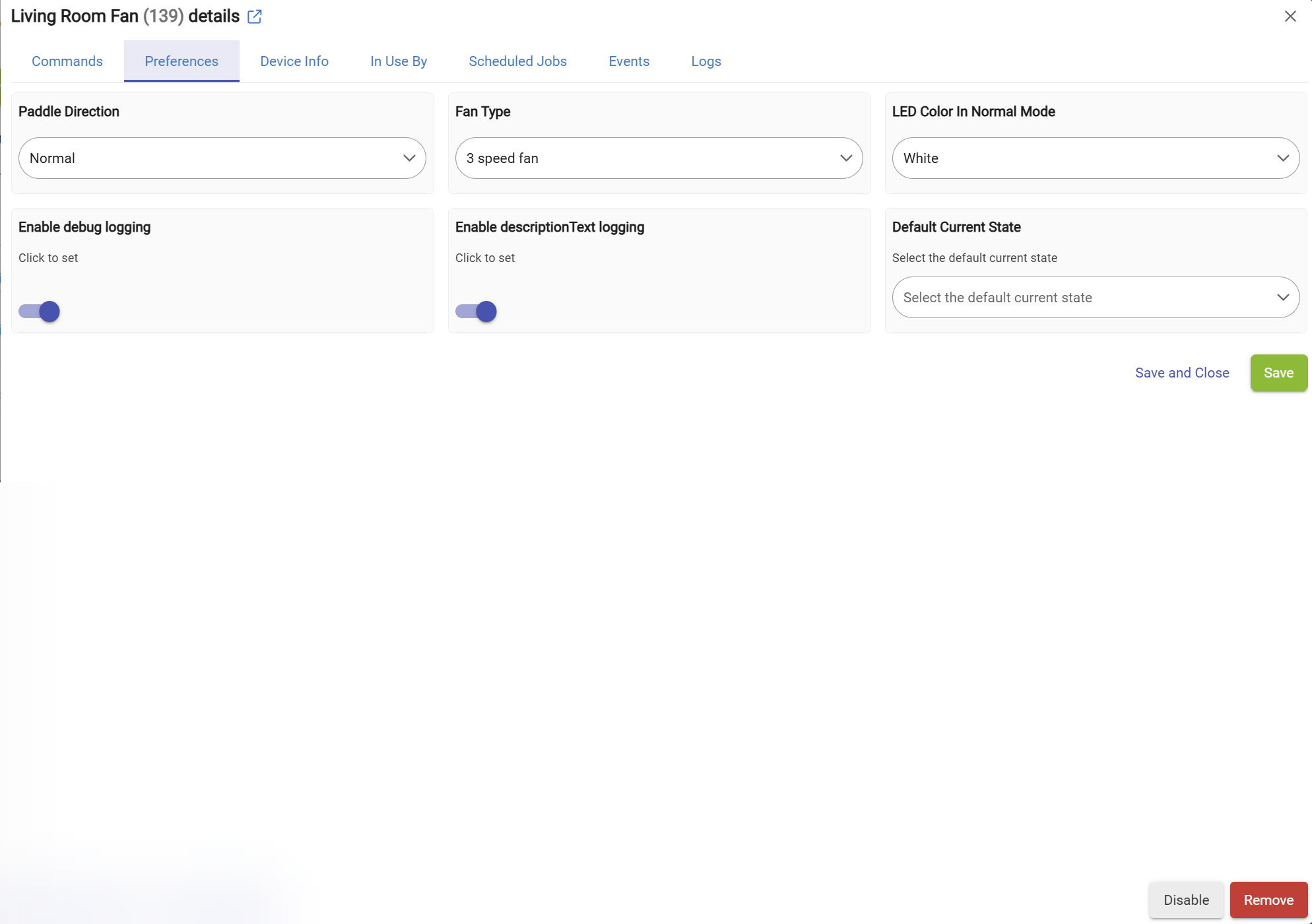

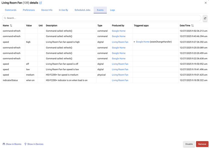

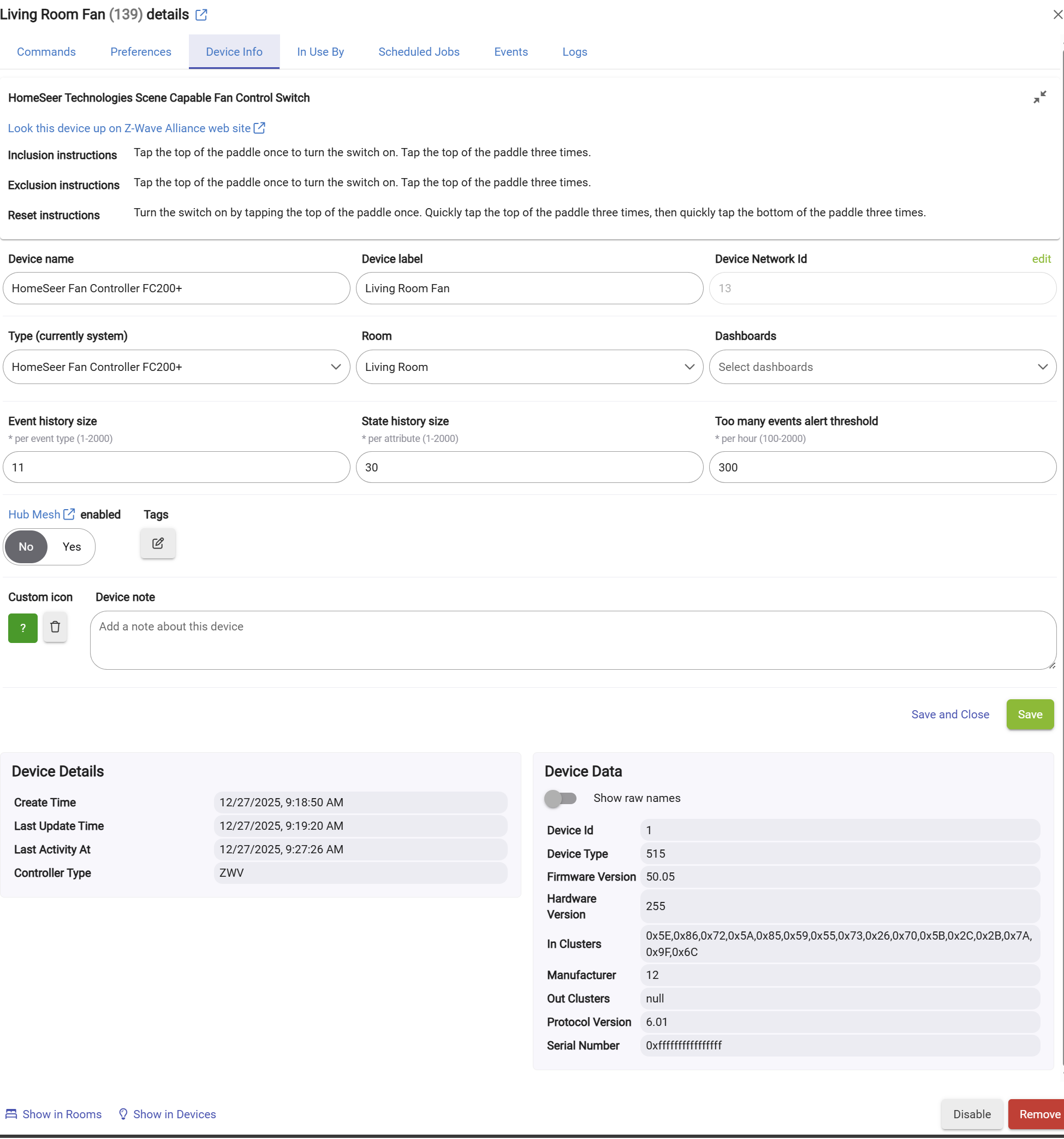

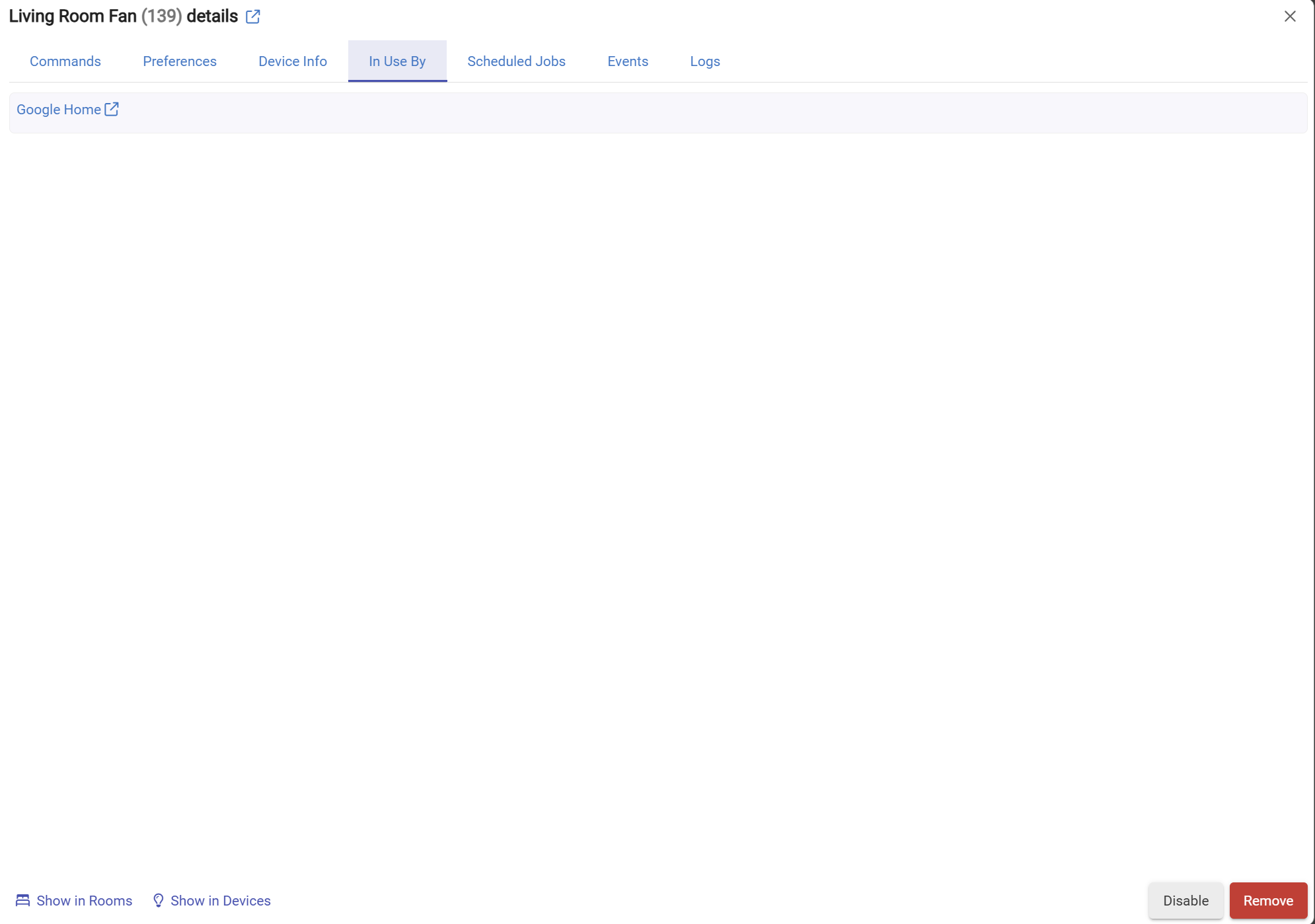

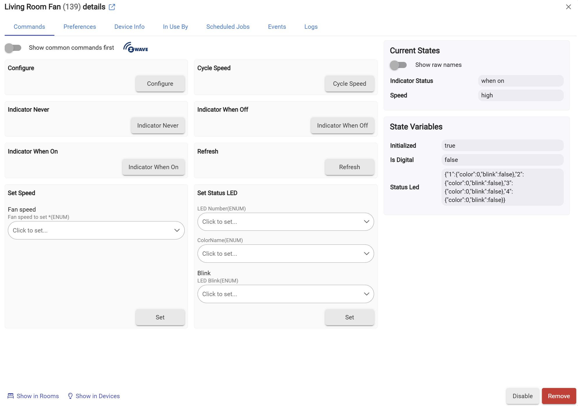

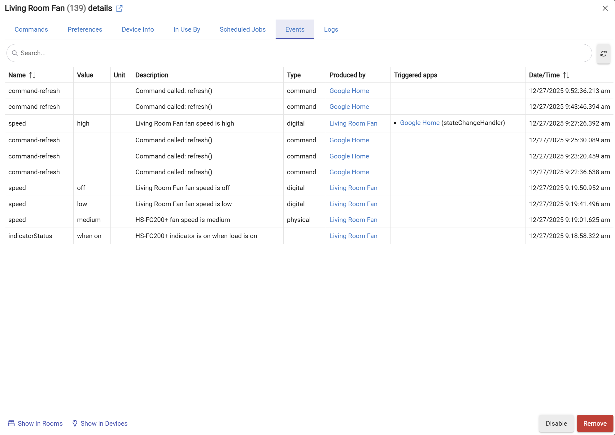

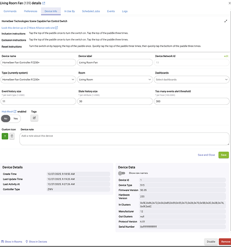

I have added my Homeseer FC200+ Fan Controller to the Google Home Integration, however it does not show up in the Google Home app on my phone.
Included screenshots:
Summary
Living Room Fan is the Homeseer FC200+
2.4.3.173

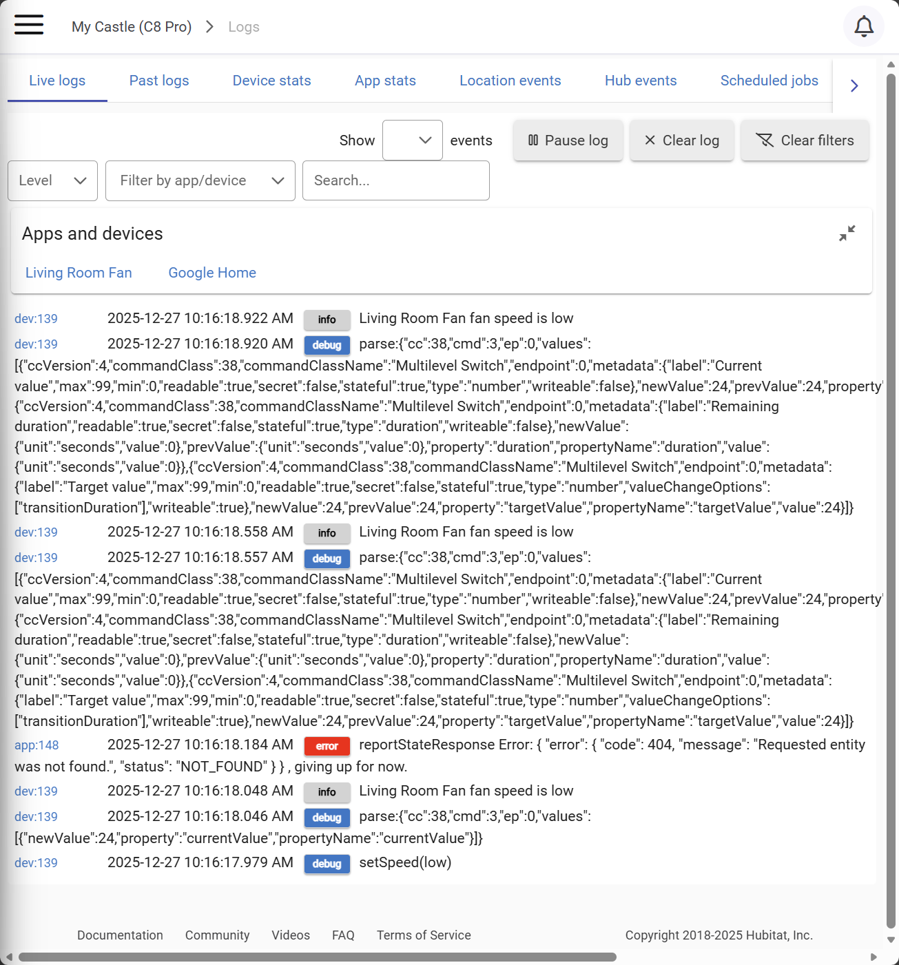

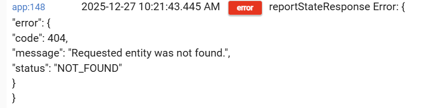

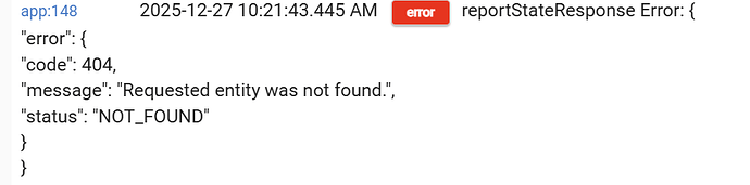

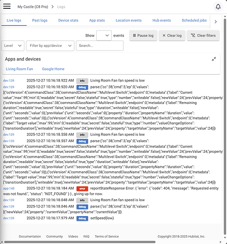

Thanks for the suggestion. I gave it a try but it is still failing to show up in the list. I suspect that Support will have to look at it as I am seeing the error:
App: 148 is the Google Home app
