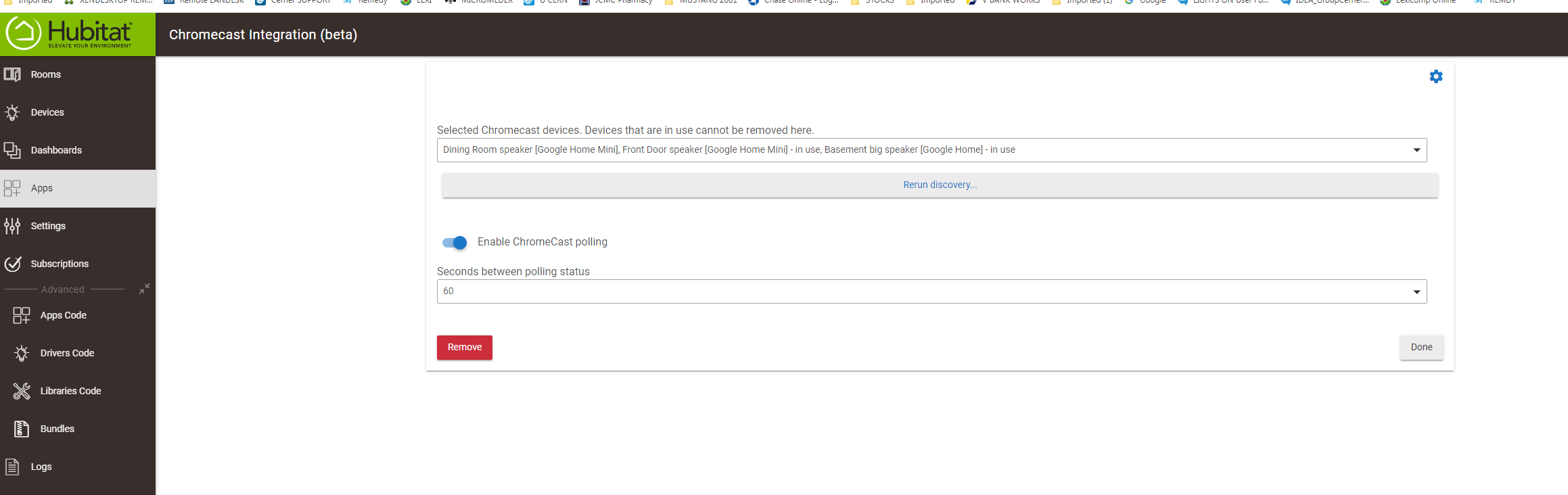

I tried installing Chromecast helper but I don’t understand how that helps my case, perhaps you can explain? My issue is with various smart devices on Znets not being properly synced to the Google cloud, which seems entirely distinct from Chromecast Helpers ability to keep native google devices alive on my LAN with pings/polling… right?
Notice the google devices are actually showing up just fine. It’s the Z devices that don’t. Also, basic controls DO WORK FINE even though those devices show a warning / offline status.
I’m an IT guy so I’m running UniFi hardware everywhere for LAN/WiFi. The devices in question are all Zwave and Zigbee (no WiFi based smart devices). Single HE hub. The devices are always showing perfectly as far as status and control in Hubitat (just for the record).
Ok, and the chromcast advice above was incorrect, that's for TTS.
