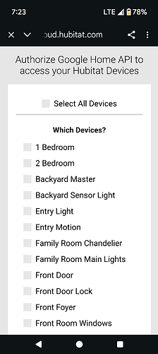

I'm trying to sync the Home/Away mode in HE with Google Home for the first time. I created a virtual switch in HE and can select it from the HE device list during the integration process. However, when I try to authorize the switch, GH returns an error that the Hubitat Hub can't be found. I've tried authorizing simple switches and lights but the same error comes up. I've reset the hub but it didn't help. The HE hub is connected to the internet and regularly updates. Any advice?

Thank you for your response I am following the instructions. The failure occurs at the step after selecting the desired device from the hub. I believe the native capability you noted only becomes available after one device is authorized in GH.
Attached are some screen shots.
Thanks for clarifying this, and providing the screenshots.

I see Hubitat devices from the GH side but it won't let me authorize any. After selecting a device, I press authorize, It comes up with the error, "Could not reach Hubitat. Try again."
