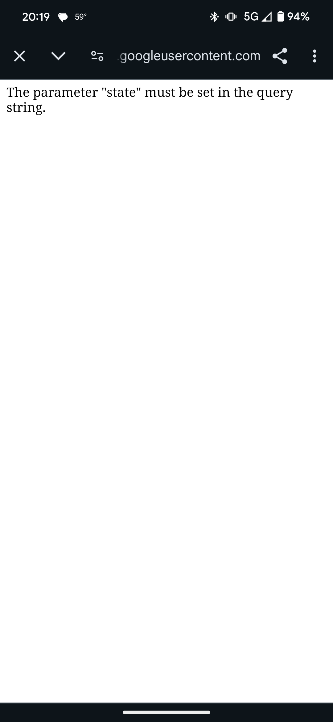

Yeah I am still showing as offline for my devices in Google Home. I tried reconnecting Google with Hubitat and I get the following after selecting the hub/location.
What platform version are you running on your C5, i.e. 2.3.9.197 (is current).
Reboot your hub and then check for updates, update to current.
You must reboot first, the update check will not work if the cloud connection is down. It will just keep saying no update available.
A bunch of the 2.3.9 builds had cloud connection issues but it has been resolved for 99% of people now.
Rebooting the hub and updating from .192/.193 (can't remember which one) to .197 resolved it.
