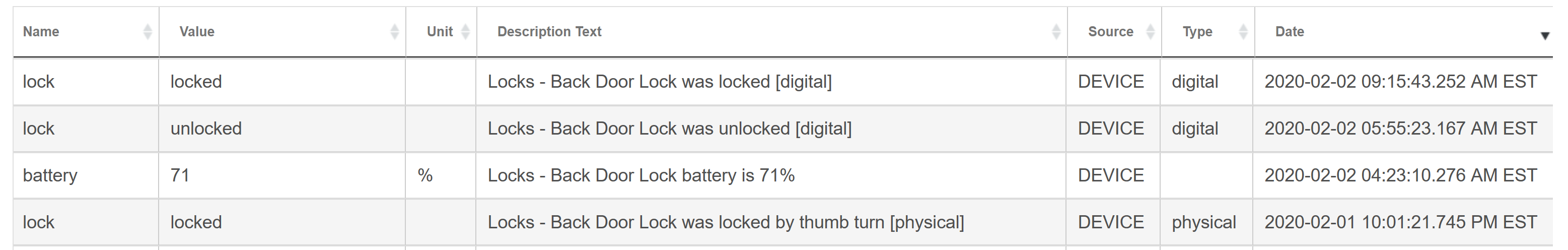

Log after button push.
Lock log (Note - it unlocked at 5:55am which is a rule) It did not seem to get the command at 9:13am but did receive my dashboard command at 9:15am (I did nothing else between the two commands)
