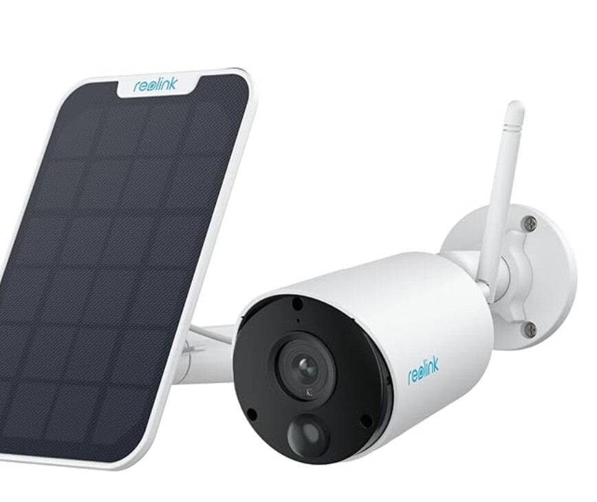

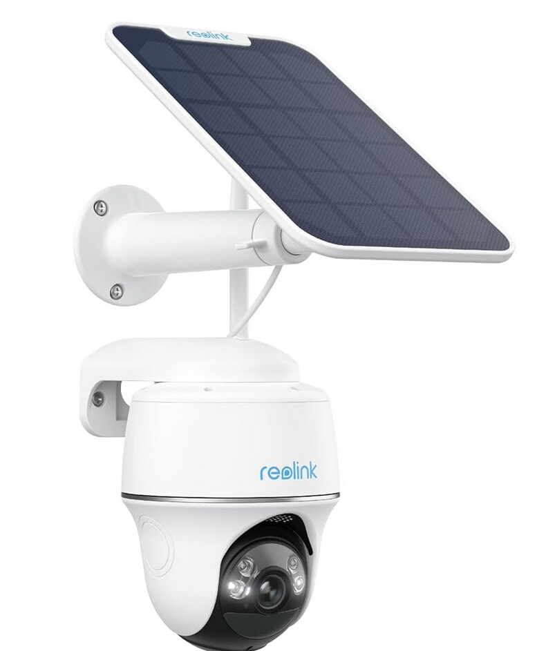

For the price these are pretty good and solve the battery issue

See my pics above. They make many more than those
