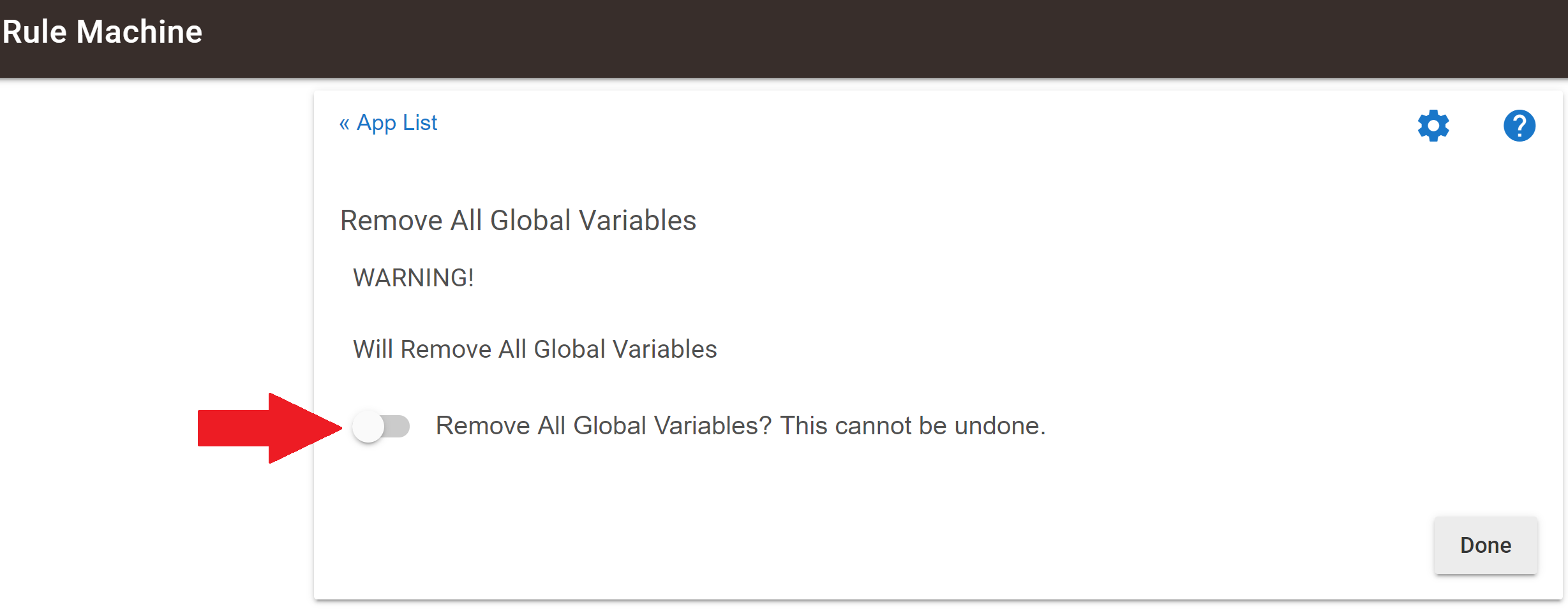

See screenshots. I have a single global variable (integer) that I no longer need to use. None of my rules currently reference it. However, when I attempt to delete the global variable I receive the following error. Any suggestions on how to resolve this?
That's not good. First thing is you have to restore to your last backup. Then delete the global variable using the Delete Global Variable on the GV page. Don't use Remove All. I will track down the problem.

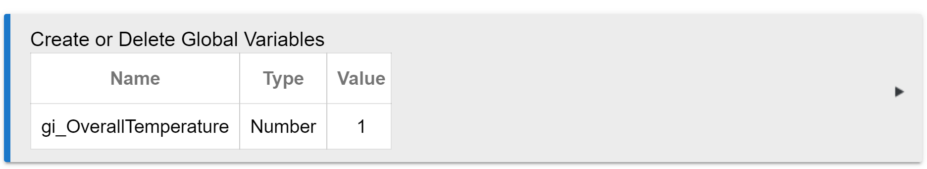

This is the global variable that's causing the mayhem... Like I said previously, I haven't used this for about a month or so. Just can't delete it!
