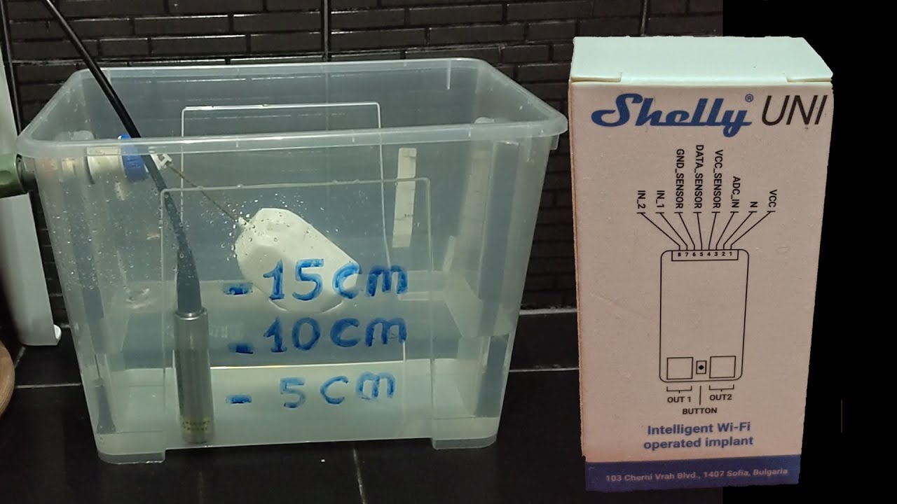

pictures attached
Btw, what kind of tank sensor do you have ? Always interested to measure other things in my own house (and I could measure the level of water inside a tank too, with floaters or ultrasonic).
I purchased the same water level sensor (0-10V) and hooked to a modbus PLC I have.
Received the unit today: it behaves as expected and the voltage, when my drain flushes, is accurate.
I just need to integrate with Hubitat the usual way for me (plc => node-red => HE)
Will replace my floaters soon (and keep one above everything as a security measure)
