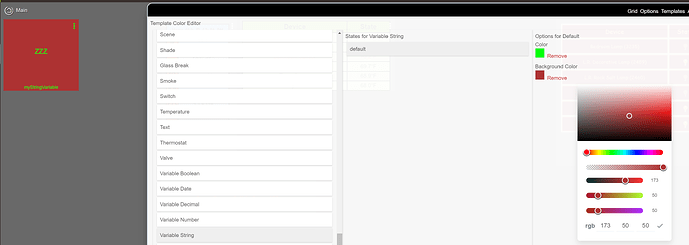

Editing the template doesn't work for you?
That is a good point, I assumed there was a requirement for multiple colors....
I see that those don't seem to work when creating the tile using the variable directly, they must be the templates for the connectors. And they seem to work when using the connector and the Variable Time template.
It does not seem so. It is a bit finicky with the saving and the refresh tho.
