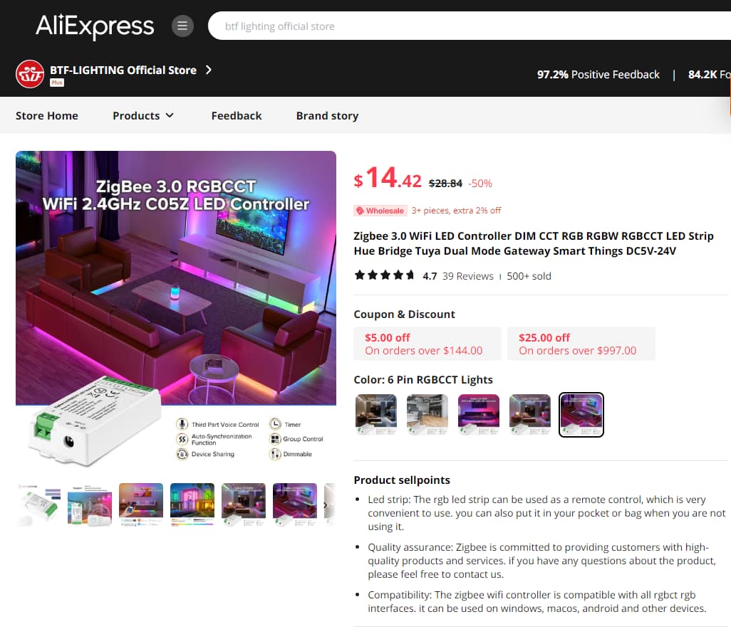

Just an FYI that I found it BTF-Lighting on AliExpress..... Just make sure to select the correct controller based on the lighting strip you are using from the five shown.
