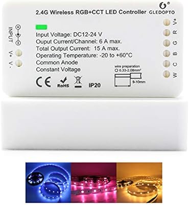

I bought the RGB+CCT and really pleased with how well it connected and physically nice to work on and a great price. However I am using the Generic Zigbee RGBW driver with some problems.
I can individually set all the colours including white temperate but when press off, only the rgb turns off, the white stays on? Am I doing something daft?
I’d previously had a fibaro which seemed to have a child device for white but that’s hard to manage like that. Any advice or am I being dumb!!
Not sure if this is relevant or the issue, but there are 2 types of controller from Gledopto; a 1 ID model and a 2 ID model (which has 2 separate channels for RGB and White). Not sure which one you have, but my understanding is that the 2 ID model is still not properly supported by HE (there are many posts on the subject). I've put my 2 ID controller on my Hue hub directly, which does support the device. It effectively provides 2 devices (1 for RGB, one for white) which can be controlled independently and works perfectly.

I tried my luck with the RGB CCT version last night. The amazon ad says its a 1ID and only a single device showed up.
It came into HE using the the Generic Zigbee RGBW driver. My use for this module is to just PWM some 12v white LEDs so i am not concerned about. Using the C only output with a color temp of 2250 seemed to give me the best range.
Three hours later the device is not responding. The sonoff basic ZBR3 devices in the same room are all still responding. Power cycled the GLEDOPTO and its working again. Tried the Generic Zigbee CT driver. A couple hours later it's not responding again. Definitely a shame because they are cheaper than the zooz RGB and it was nice having the barrel jack plug for power.

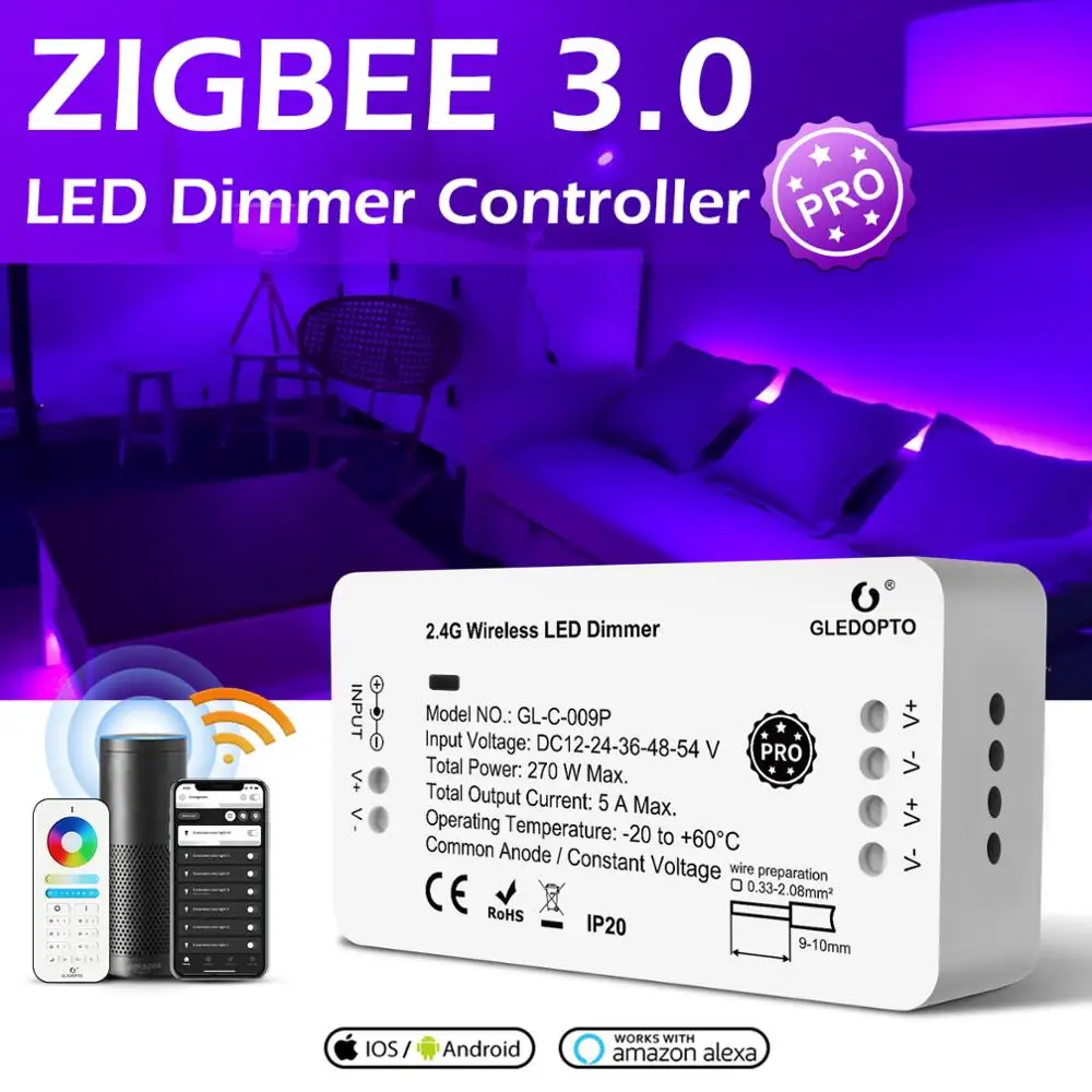

I bought the GLEDOPTO GL-C-009P, to control my white deck LED's
Hubitat recognized like "Advanced Zigbee Bulb"
I made a test with 2 LED's works well.
The website shows as Zigbee 3.0, I hope this is true and works well because all my Zigbee devices have a problem with keeping connected to the hub.
