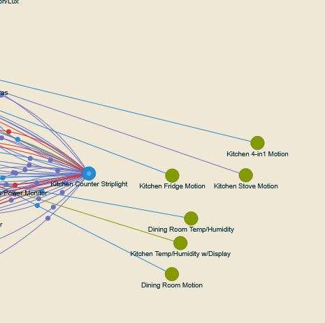

My kitchen counter uses this model, and as you can see the 6 nearest endpoints, some 3’ away, none more than 10’… not one of them is connected! And yet that sucker is heavily connected in my mesh to other routers. It’s as if it only connects TO routers.

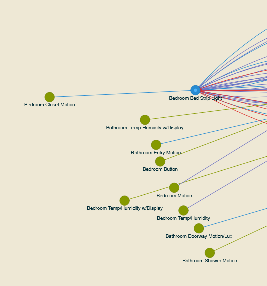

My theory broke however - I also have the exact unit in the bedroom as an under Bed strip.
It’s nicely centered to the room and should see and hear lots of endpoints.
But one device IS connected to it … so - is it possible it’s the order a device gets connected to the mesh? I rebuild my Mesh occasionally - the old ‘Turn off your HE for 20 minutes and cause the ‘panic’ but I don’t think that causes endpoints to redetermine a parent. It sure is odd!

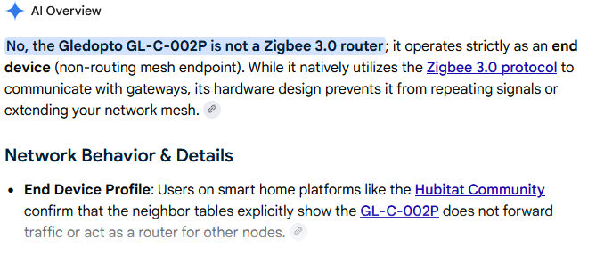

Then to make matters worse - Gemini says it’s not a router! I thought maybe it was 2.0 router but supposedly it doesn’t do any routing. Yet my discovery shows it in blue, which according the the zigbee map legend IS a router. so wierd! Then another search on is it a router says other user report it is a router… wow. this is a deep hole! I’ve got a Kasa 3.0 in wall switch 3’ away from either unit - I’m just relying on that!
