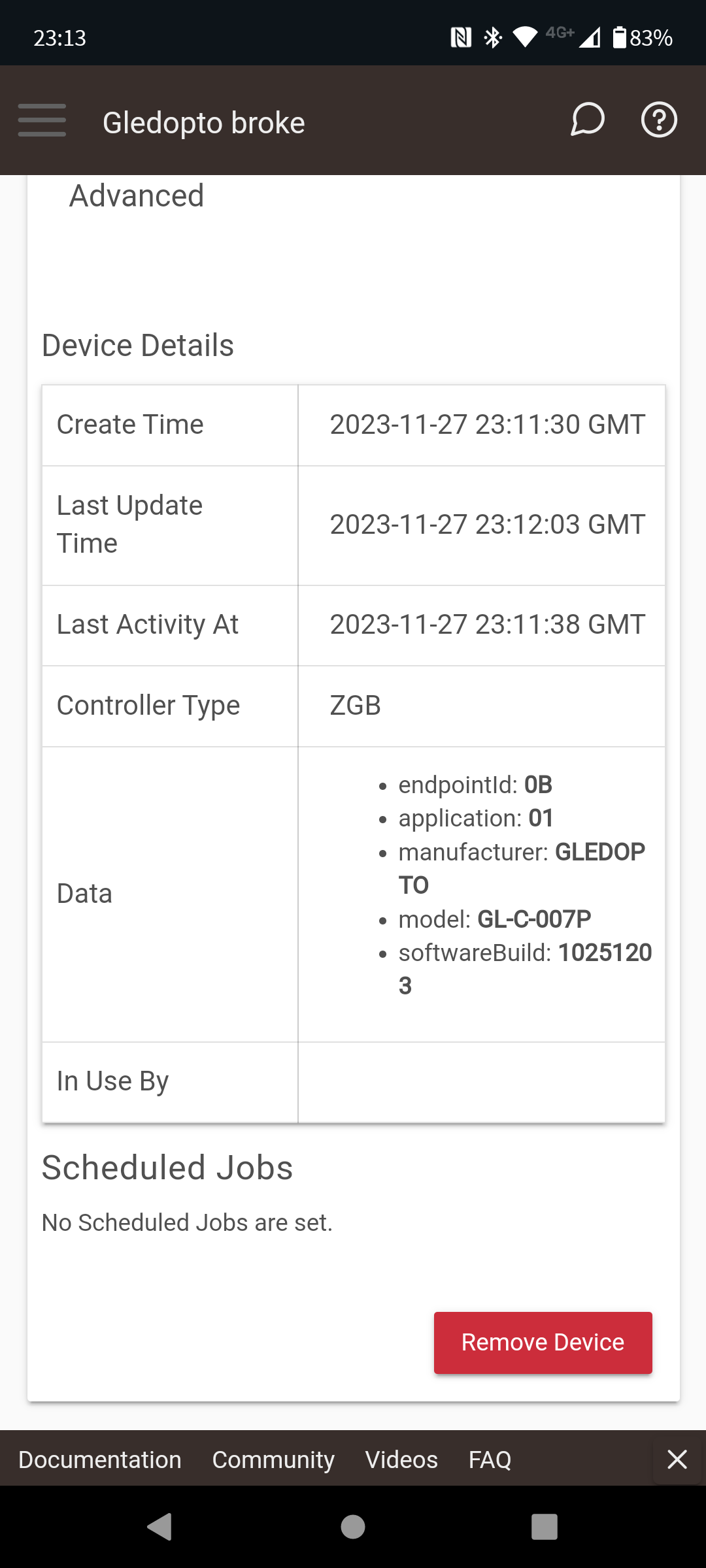

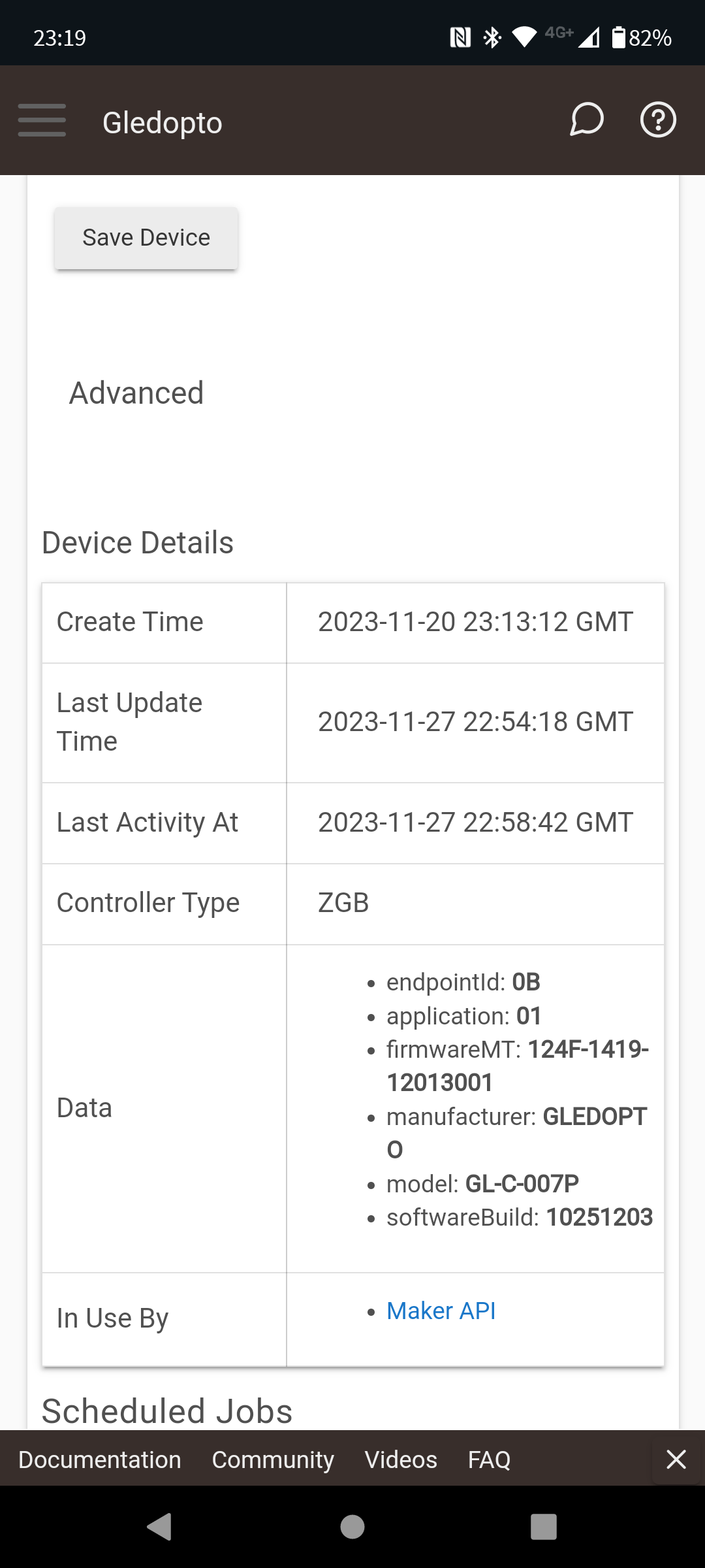

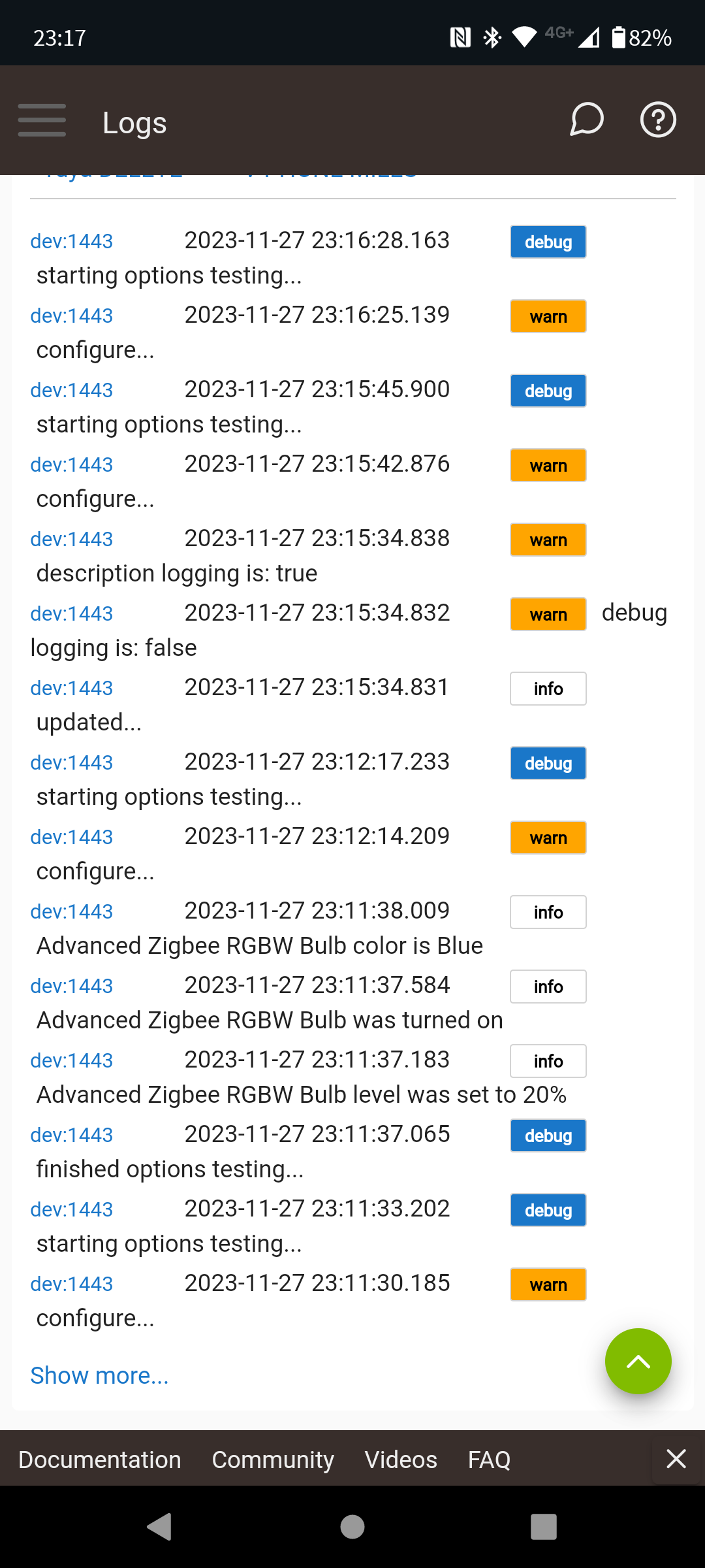

So I have a similar problem. I bought 2 controllers and I can only get one working. Despite approx 8 re-pairs of the 2nd controller, it won't display the firmware in the data section. I've shown the logs and data in the lower 2 images. The top image is my working controller which is showing firmware. Any advice would be helpful and appreciated.
PS I'm using the Advanced Zigbee RGBW Bulb driver as the Generic Zigbee RGBW Light driver didn't work on either controller.
