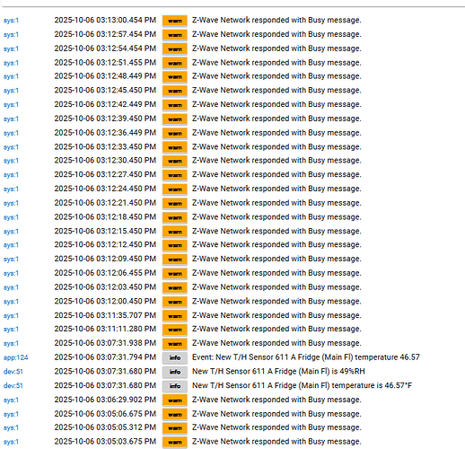

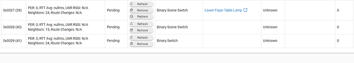

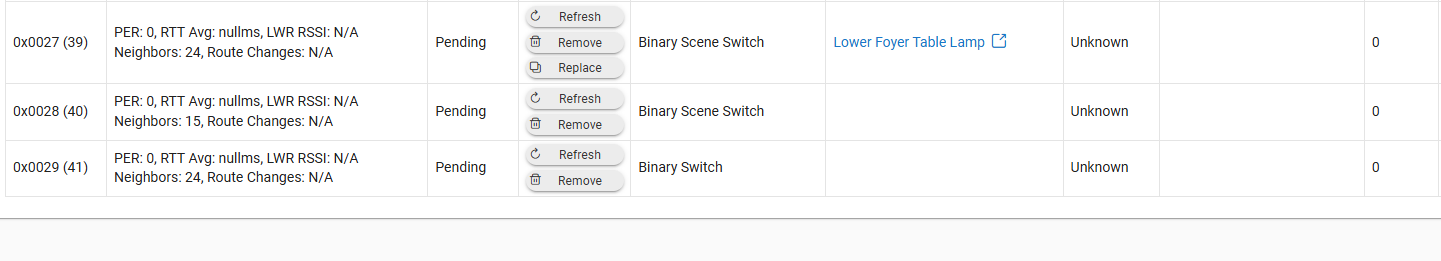

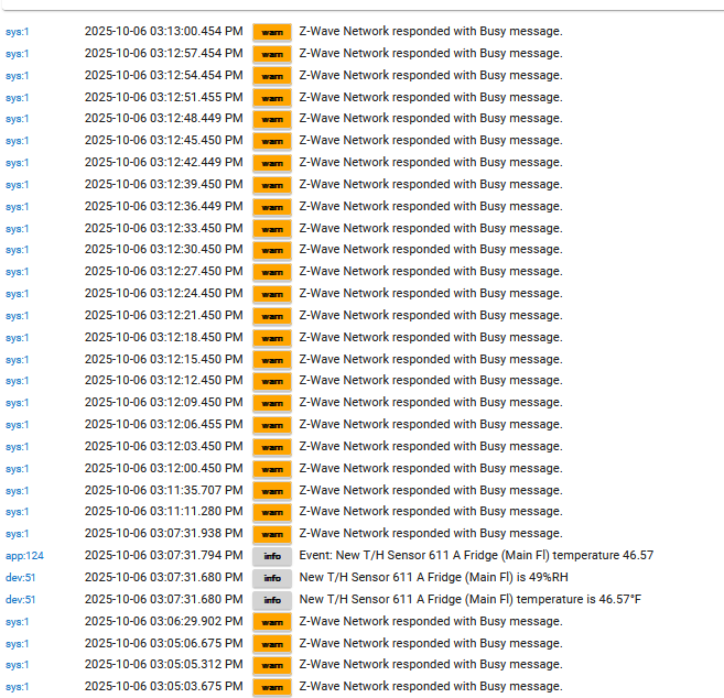

Trying to remove a ghost zwave node (0028 (40). Its is the last item in my list and with it there I can no longer add additional items. Now I am stuck and still have another 20+ devices to include into the network. I even tried a virgin ZEN04 800LR and it go to S2 security part of inclusion and when I responded with the digits it never finished inclusion and simply timed out.
I press the refresh button but it never comes back with the remove button that I used before to clean up Ghost nodes. Discover comes back right a3way with no info or status and rebuild route takes a long time and errors out.
