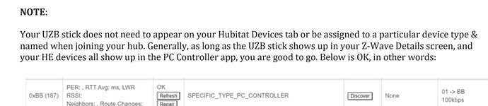

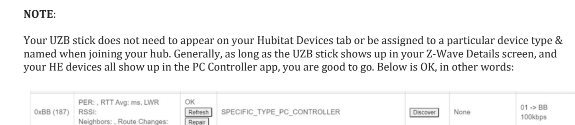

Were you using the document here? https://www.dropbox.com/scl/fi/hb6pydlm3v745ygi9li7s/Hubitat-Remove-Ghost-Instructions.pdf?rlkey=gohxub552bnper43uq4djczhn&e=3&dl=0
If so, did you see this note after step 12? There may not be an issue with the pairing of the Z stick. I recall when I did this, it looked like a ghost also. But it worked regardless.
If you were not using the document, perhaps it would help with getting the devices to show up so that you can remove them.
