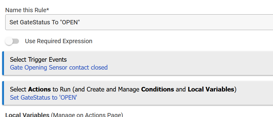

I made a rule with a Hub variable named GateStatus. If "gate closing sensor" = closed, then GateStatus = closed. If "gate opening sensor" = closed, then GateStatus = open.
Once I know the GateStatus I can do other stuff. I display it on a dashboard using Attribute type.
I created a virtual switch called "Gate Switch" that switches the gate operator relay in the ZEN17. I have to make sure that switch is updated with a rule to what the GateStatus because the outdoor hue motion I have mounted to a tree switches the operator directly and doesn't go through Gate Switch.
