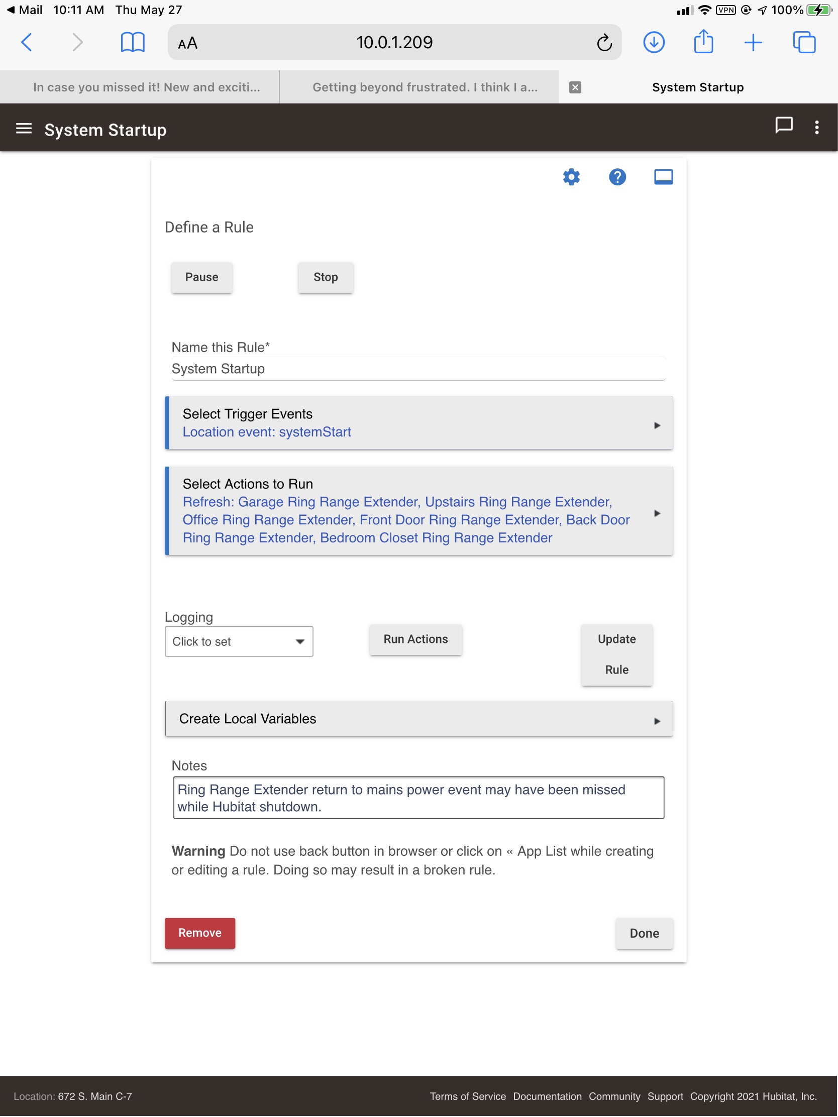

How do you have this setup. It sounds like a very good idea, but no clue how to setup a rule to accomplish it. I did order 4 Ring extenders. Thanks
It takes 2 Rules and a driver.
First, in order to be able to shut the Hub down cleanly, install Dominic Meglio’s (@dman2306’s) Hubitat Hub Controller. It installs using HPM, which you already installed. Just search for Keyword: Controller and you will find it, install is straightforward.
Then, once it’s installed, install a virtual device on the Devices page, select Type Hubitat Hub Controller (the User-contributed device drivers are at the bottom of the list), Save, Configure. Leave the Hub address at 127.0.0.1 (localhost).
Then, after you have paired the Ring Extenders:
Install (enter) the following Rule to detect power fail. I see if all power fail events are seen; that way, if I take one out to move it as I try to determine best placement, or if one gets knocked out of the receptacle during cleaning, the hub doesn’t shut down. Perhaps I should do a voting algorithm instead, see if a majority fail, or at least two. That’s another project.
Note that it calls the Hub Controller driver to do the shutdown (Run Custom Actions, Actuator, select Hub Controller device you added above).
Then, install the following Rule. The problem it solves is that, when shut down, the hub misses the “Return to Mains” power event from the Ring Extenders, so we refresh them on SystemStart (a built—in Location Event, for some reason).
As always, ask if questions. Good luck.
