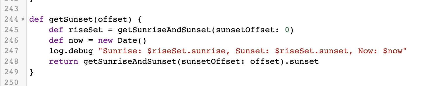

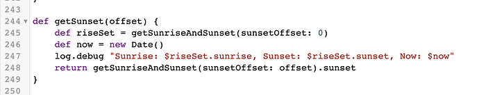

Here's the debugging code that simply logs the current sunset, sunrise & now:
The actual log is: Sunrise: Thu May 21 05:54:00 PDT 2020, Sunset: Thu May 21 20:16:00 PDT 2020, Now: Fri May 22 09:18:46 PDT 2020
You may have noticed that both sunset & sunrise is for yesterday.

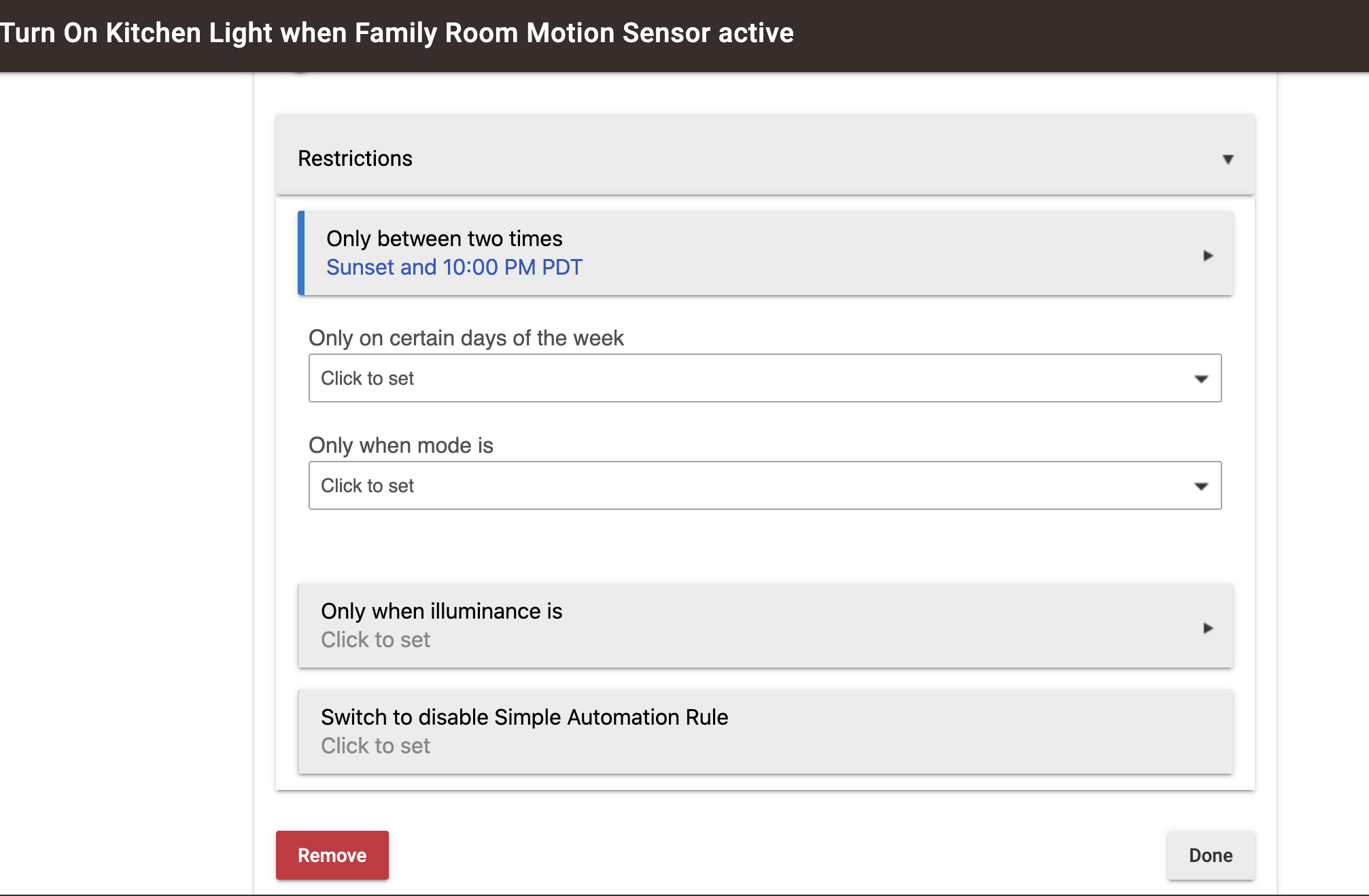

This triggers time check like "from sunset to 10PM" because it's translated to "from sunset yesterday to 10PM today".

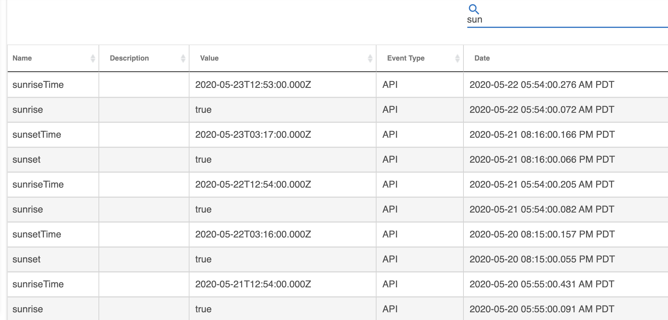

The system events for sunset/sunrise:

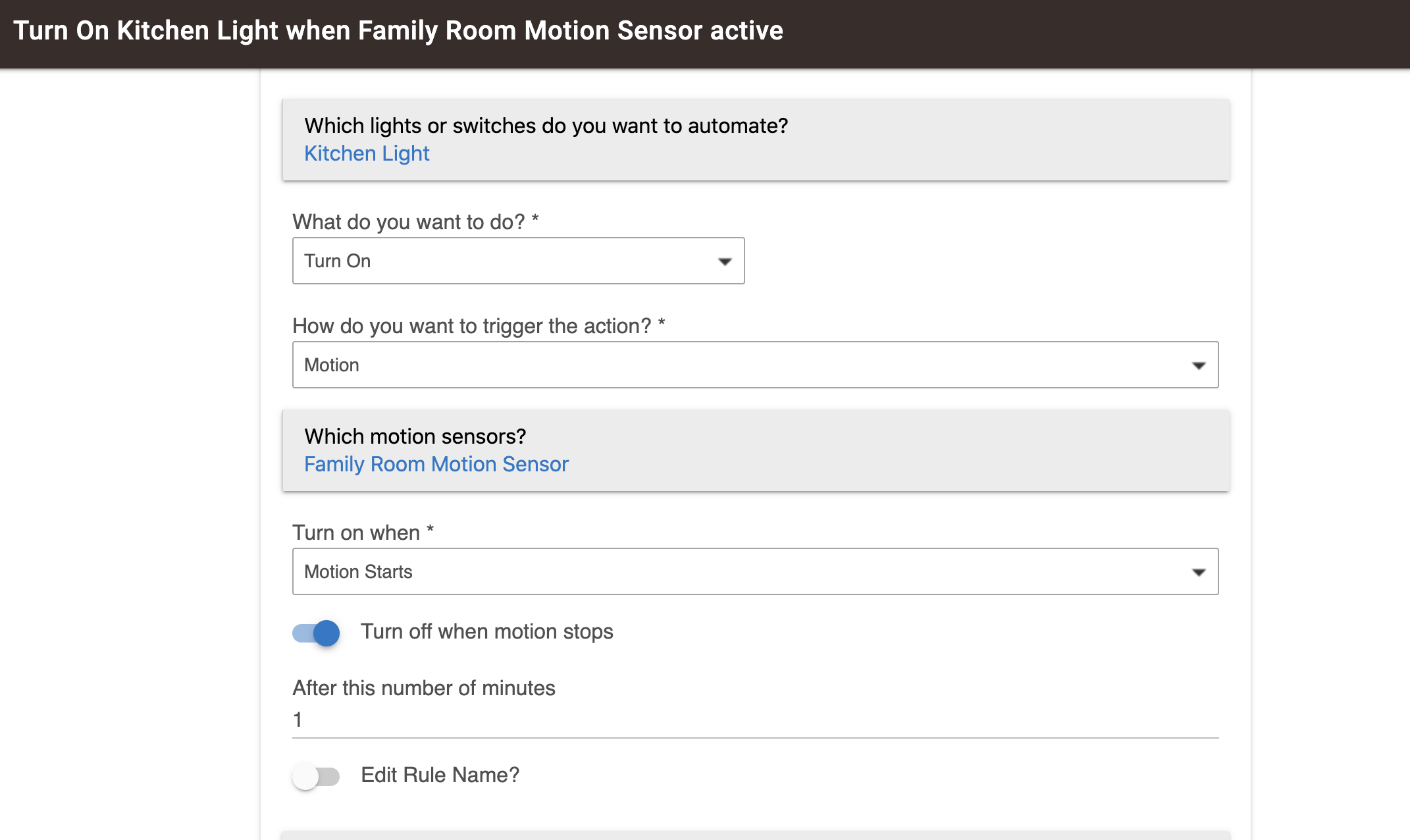

I then created a simple automation test rule to see if this bug affected to other app, and it did. The SA rule have time restriction "From sunset to 10PM":
It was then triggered @9:25AM:
