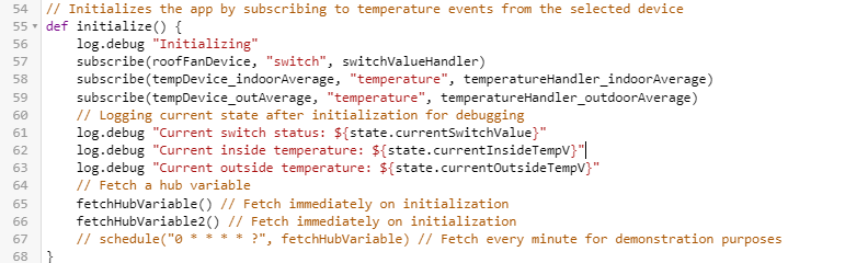

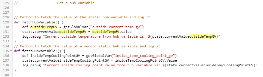

When the code was working fine with the solution you suggested, I first added a second parameter in the same method, thinking I could fetch anotherone. But that did not work, I got an error. So I then removed the second variable code and copied the working code and created a basically identical method with only the variable names replaced. Much to my surprice, the second method gets an error. That was strange I thought. Any ideas on why that happened?
(the only difference between the two hub variables was that the first one was of type 'Decimal' and the second one 'Number'. But I changed that and replaced the number one with a decimal one. I don't think it matters.)

The value property should not have an uppercase V (nor do conventional property names in Groovy, though it won't stop you....).
Thank you @bertabcd1234 ! I did not know that. That did the trick and now it works!
Very much appreciated! Again, Thank you!
