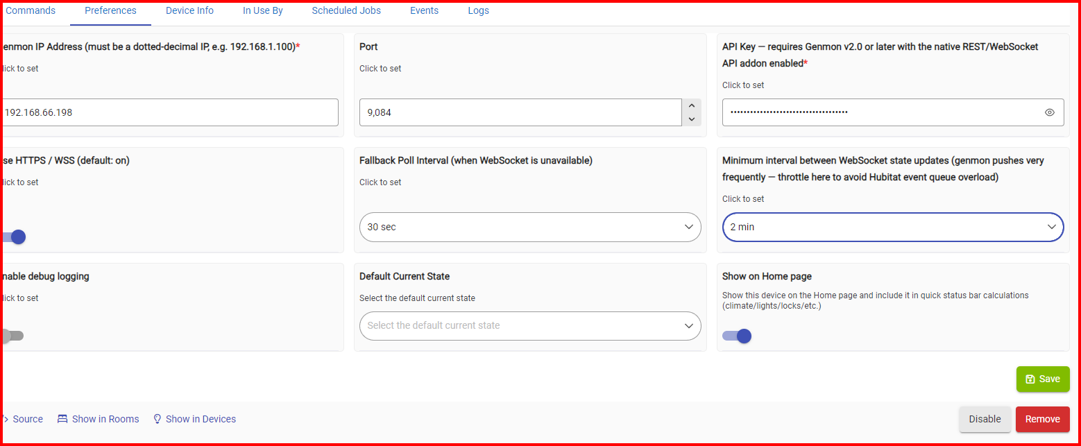

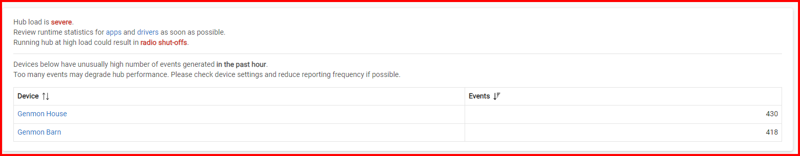

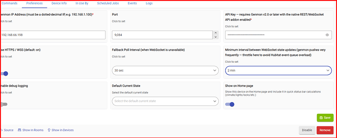

Hi, I setup the addon in Genmon and then set it up in Hubitat. But now i am getting complaints from Hubitat about usage.
I did set the threshold for 2 minutes as suggested
EDIT: I see now that this is expected behaviour, based on the config file at /etc/genmon/genhubitat.conf
so i guess i will have to edit that if i want the load decreased
Any othor options or something i am missing?
EDIT #2: Even after changing the conf file to 10 seconds and rebooting it is still reporting every 3 seconds

I removed the addon from genmon and then re-added it and it now is sending the updates every 2 minutes correctly. not sure what went wrong but it seems good now
Thank you! I've applied your updates and committed. I couldn't replicate the issues above from @tinker3433 either, so I'm glad the re-install fixed it.
