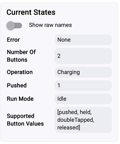

Can you screenshot the "Current States" section of the driver page?
The following are from a different driver I was playing with before the Matter RVC driver came out.
Number Of Buttons
Supported Button Values
Pushed
Setting clean modes does seam to work, at least it shows up as changed in HA and the app when done from HE.

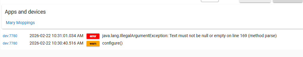

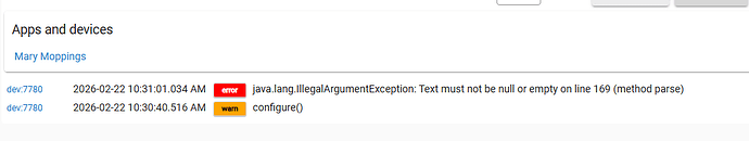

I have a Dreame X50 master and it seems to work with the driver but i do see this error?
Hit configure .. It's missing some state variables that it gets from initial polling..

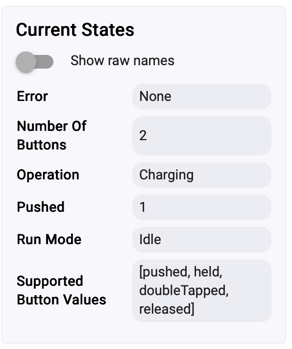

same.
What is that line looking for?
That line assumes "supportedCleanModes" is populated..
so that seems to be blank as a option

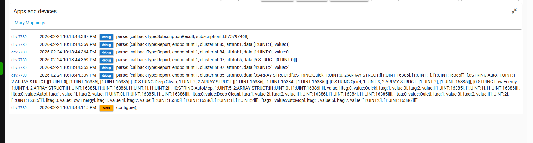

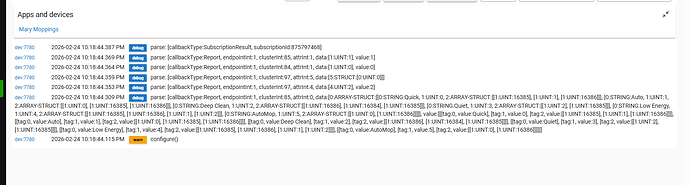

Strange... Can you enable debug logging and then hit configure again and put the log here please?

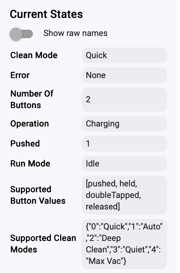

I have hit config multiple times but now with debug on this filled in straight away
Ok.. It reported it that time..

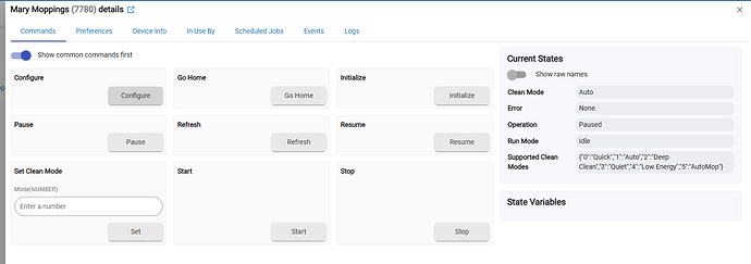

Weird..
SupportedCleanModes is populated now.. So you shouldn't get that error anymore..
is there a bug in the code that it only populates if debug is on?
Nope.. It processes any time it receives that report.. I'm guessing either the request or the report was getting lost..
