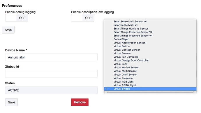

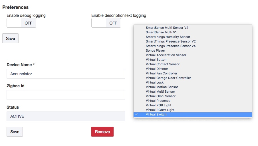

Click Devices in the Left Pane, and find your device (center pane) and click it to edit/observe
There's a Type field above the REMOVE button and it's a selectable field. The Custom Drivers you add yourself are at the end of the list. The Hubitat provided drivers are at the top.
My plug in dimmer is set as a generic dimmer but is in an unknown state. Maybe I need to exclude and reinclude the device.
It won't always help BUT there are TWO save buttons... be sure to click SAVE for the device type/name/id# change and THEN adjust the parameters. Then click the SAVE for the parameters. So.. even for a device you don't alter.. two SAVES.
The second save fixed the issue that I was having. Everything seems to be working now.
