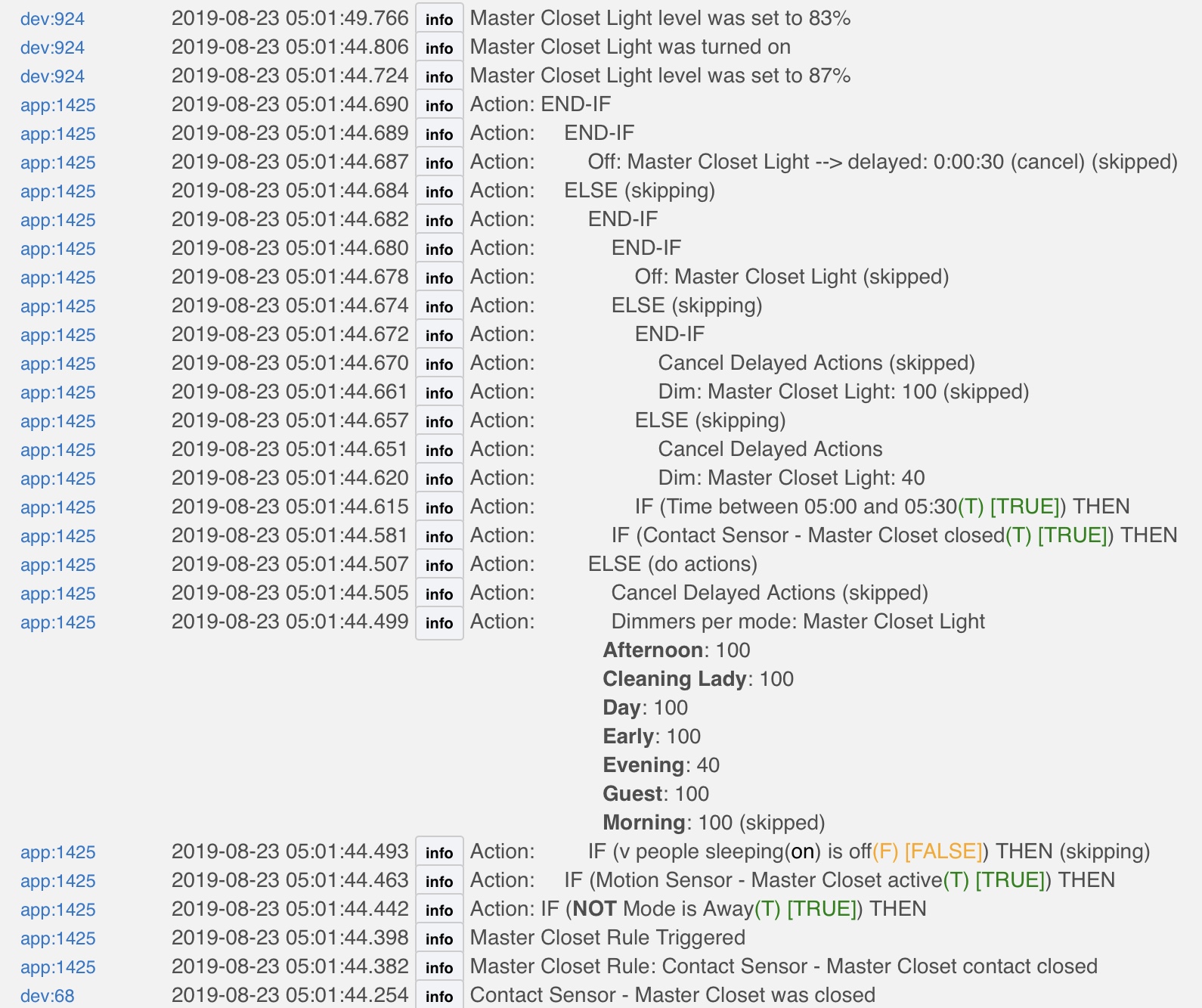

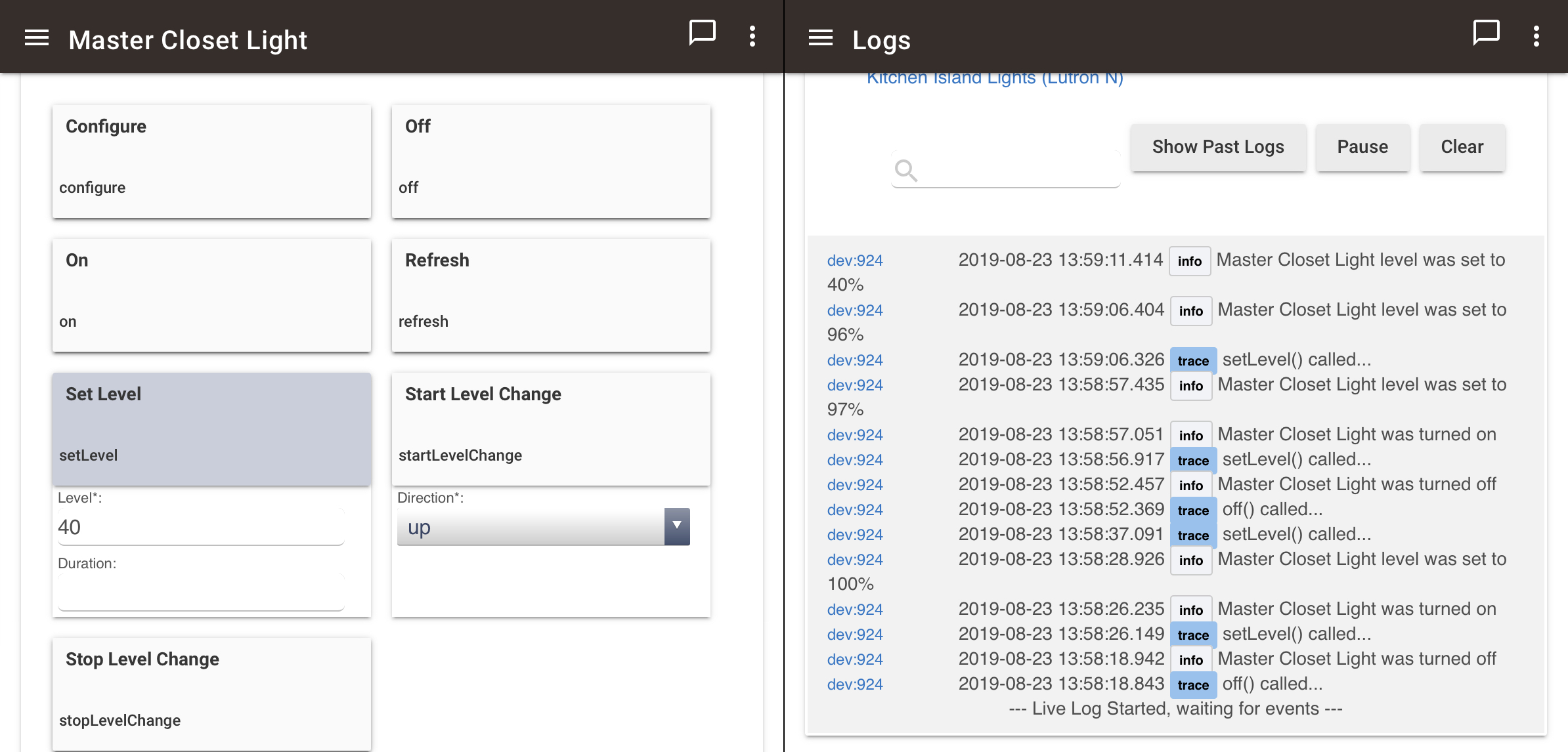

I’ve noticed some inconsistencies with the new driver. issuing the set level command from the new driver will turn the light on, but will not set the level. once the light is on, issuing the command again will cause it to change to the correct level. here is what happened this morning when my rule machine closet rule went off.

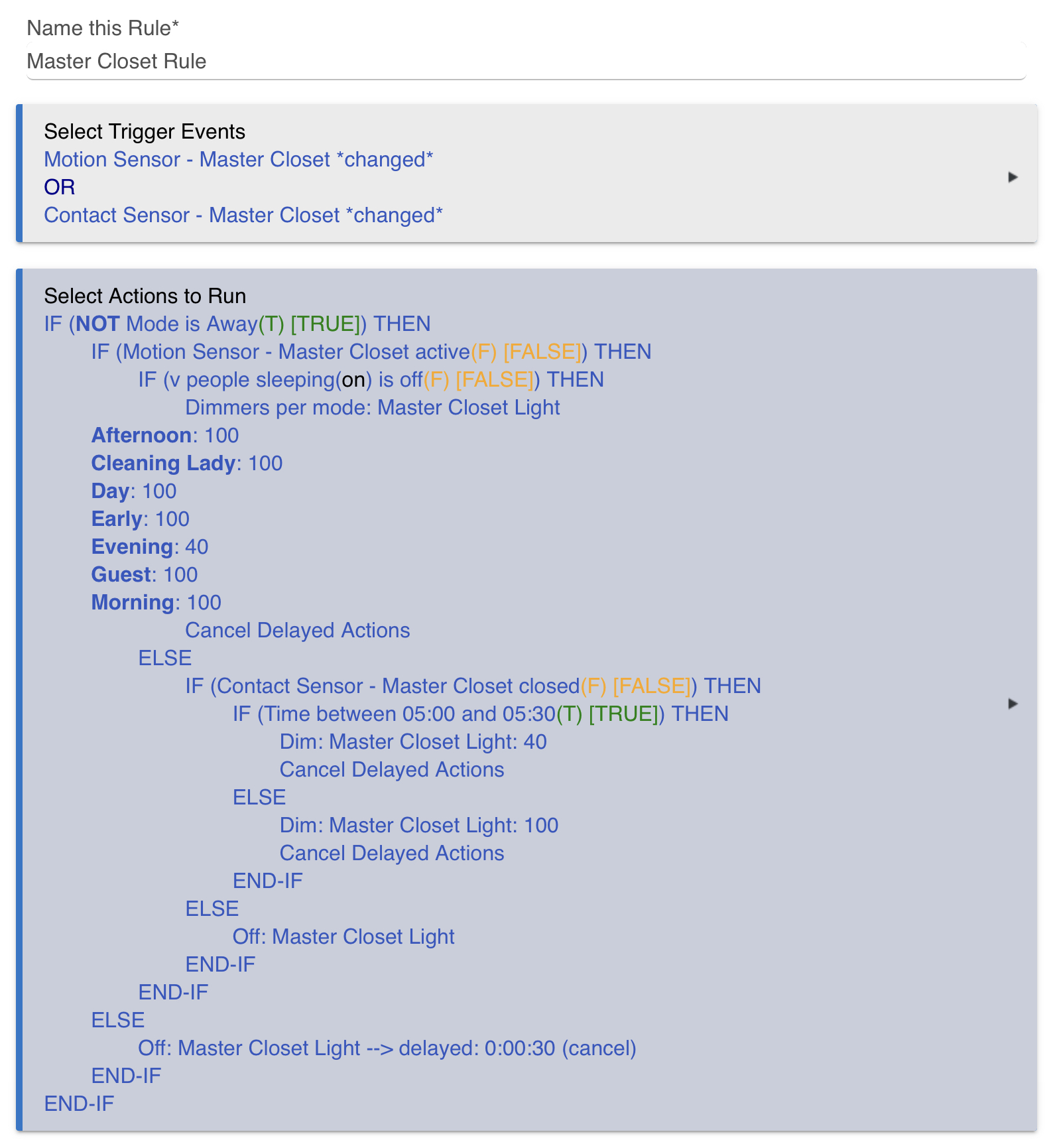

my closet light rule fired:
as you can see from the log it was supposed to set the light to 40%, but instead sent a command to set the light to 87% and the light turned on at 83%.
I then stood still in the closet looking at hubitat logs on my ipad for long enough that the motion sensor reset, and the rule fired again when I moved. when this happened, it dimmed the light to 40%.

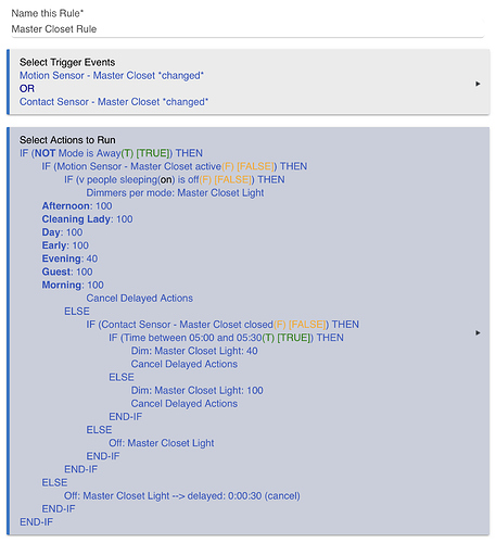

There's no way I am going to dig through that rule.

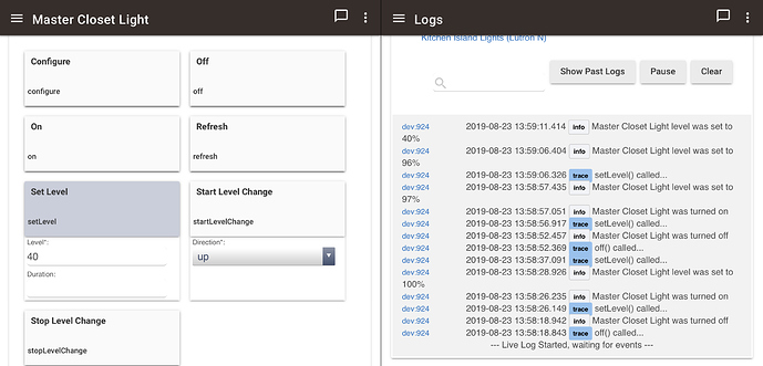

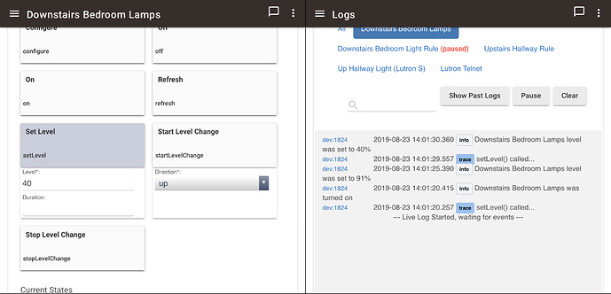

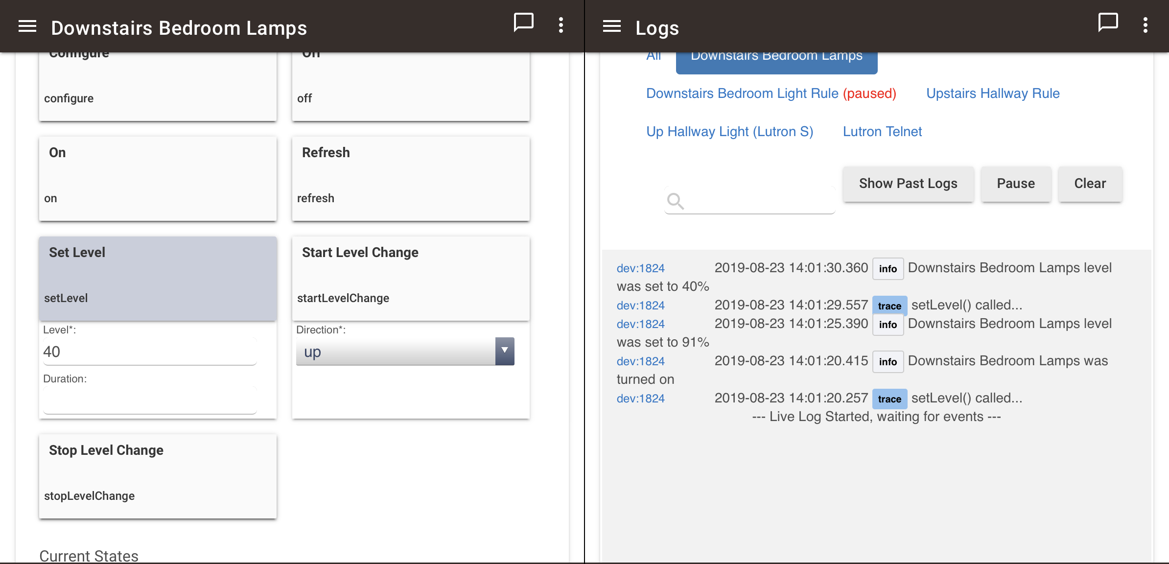

I have both the 45857 in wall switch and the 45852 plug in lamp dimmer and they are both displaying similar behavior.
If they were last turned off from a level of 100%, when they are turned on by a setlevel command at 40%, they turn on, but near 100%. in watching the logs, after issuing the command, 3-5 seconds later it seems to refresh and will display the level value in the logs. If I issue the command a second time, then they will adjust to 40%. But they will not adjust to 40% directly from off.
in-wall dimmer:
plug in dimmer:
I also am getting weird behavior with this driver on a 45852 plug similar to jrau272. The dimmer no longer appears to miss any ON commands, but the intended brightness does not work as expected.
I tried repeatedly turning on at 20 or 30 or 40 percent. Every single time it would pick some random brightness near or above 80%. I got things like 83%, 87%, and so on. It never hit the same number twice over the course of about 2 dozen on/off cycles even if you asked for something like 30% over and over again.
Once the light was on, you could ask a second time for the correct dim level, and it would (mostly) work, but occasionally it would pick something like 18% instead of 20% or something like that.
From the dashboard, from an off state, if you used the slider to stage brightness and then turned light on, it would also occasionally pick some random brightness near 80% once you click the tile to turn the lamp on. The slider would pop over by itself.
It also seems very laggy compared to the generic driver. You ask Alexa to "turn the light on to X%", and it would take 20-30 seconds to turn on but react instantly when off.
