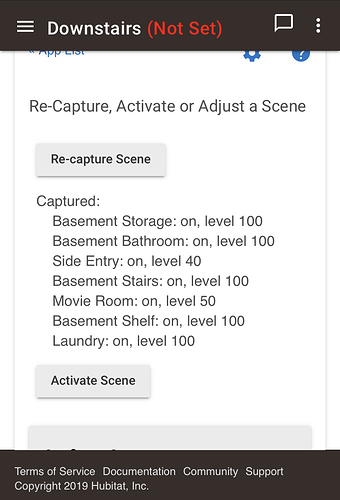

Situation:
  • I have a GE / Jasco Zigbee dimmer 45857
  • I have the driver set to Generic Zigbee Dimmer
  • I created a scene with several Sengled Classic Zigbee bulbs elsewhere in the house (dumb lamps, smart bulbs) AND this GE dimmer. All set to turn on at 50% brightness
  • All of the bulbs turn on but the dimmer switch does not, when scene is activated.
  • if I set the dimmer to 50% and turn it on via the device page for the GE Zigbee dimmer, it turns on properly
  • ISSUE: The scene can’t turn on the Zigbee dimmer and I can’t figure out why. (Screenshot for scene settings)
‘Movie Room’ is the GE Zigbee dimmer. All other lights are Sengled Classic bulbs in other rooms.

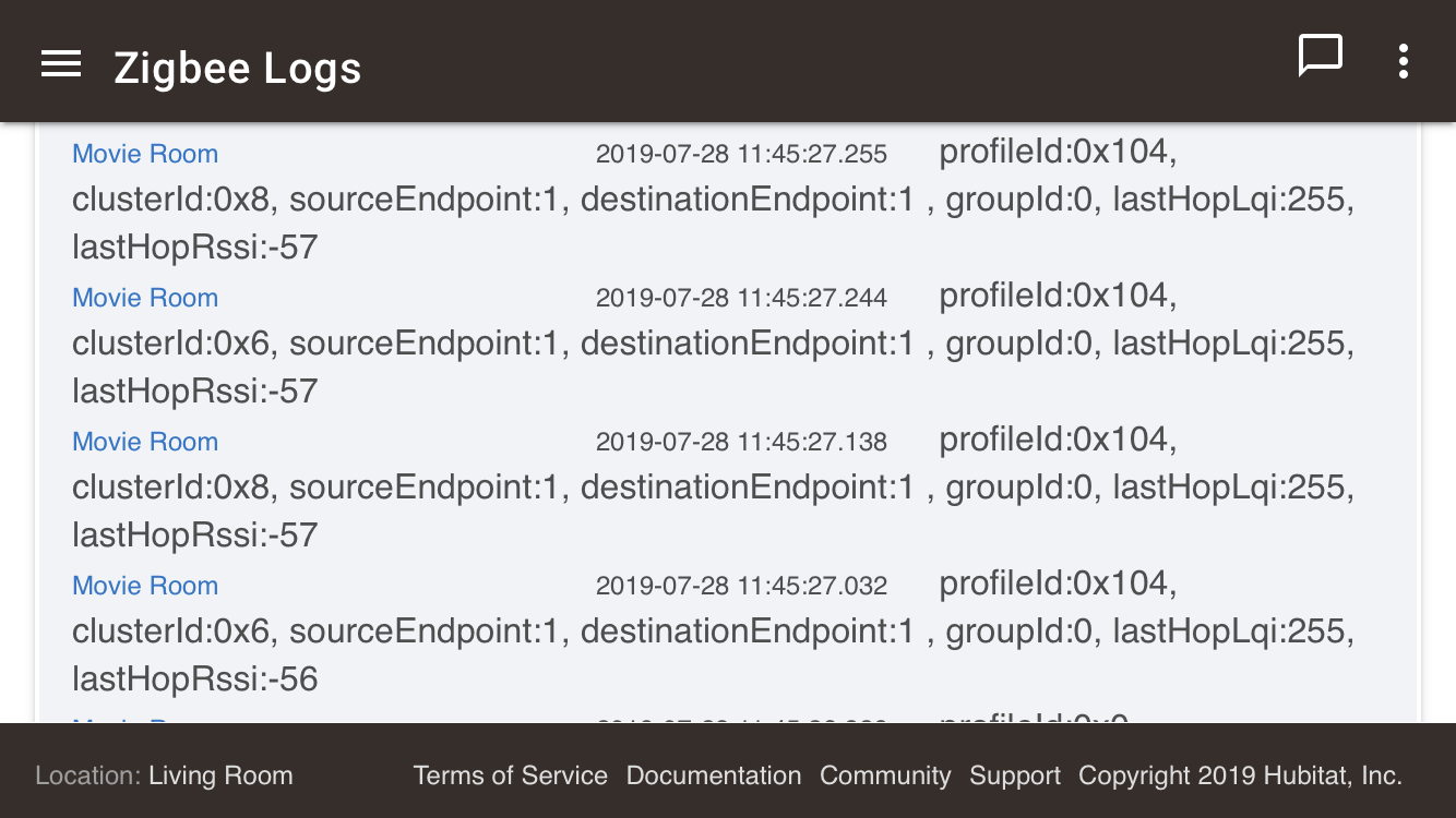

Here are my Zigbee logs. Does not appear to be a mesh issue
Thanks!
Does the dimmer not physically turn on?, or is it just the driver page showing the dimmer being off...
Also does the dimmer turn on when off and a setLevel command is sent?
Does the dimmer physically turn on:
  1. No, if activating the scene above
  2. Yes, if I physically press the toggle on the dimmer
  3. Yes, if I turn on the dimmer from the device page
  4. Yes, if I turn on the dimmer in the dashboard
Does the dimmer physically turn off
  1. Yes, if I ‘turn off’ the scene “Alexa, turn downstairs off” or if I turn off the scene via the specific scene page in the HE interface
  2. Yes in all other scenarios above
Does the dimmer turn on when setLevel command is sent:
No
I can change the level via setLevel after the light is on, however.
I don’t know if it matters but I picked up this switch during the prime day sale just a bit ago. Perhaps there was a firmware update to them in the past year or so?
