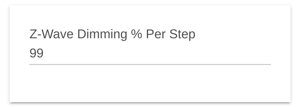

On all of the GE/Jasco switches you can adjust dimming speed. Crank up the %/step to something huge and it basically acts as a switch. (EDIT: those settings aren't exposed on Enbrighten dimmers)
Like this when using my dimmer driver (not sure if you can do it with the in-box driver as I don't use that driver):

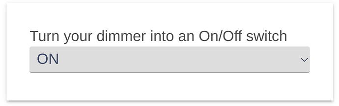

Or if it is one of the newest Enbrighten dimmers, they actually have an option to change operation to switch mode directly.
Like this if using my Enbrighten dimmer driver (no idea if you can do this with the in-box driver, as I don't use it):

OK, then it is picture #2 in my post above, if using my Enbrighten dimmer driver.
Yes these are the newest Enbrighten ones where you can change modes from dimmer to switch.
It didnt seem like this one let you play with the %/step levels? Maybe I didnt read the reference properly - do you think these let you set those?
You're right. I forgot that they don't list the %/steps on those. I think the settings exist in one of thee zwave parameters, but it isn't documented. Sorry about the confusion there.
EDIT: I took a quick look through the 1st 100 parameter setting slots, and didn't see anything that looked like the old steps / %/step settings. So maybe it isn't hidden in there somewhere.
