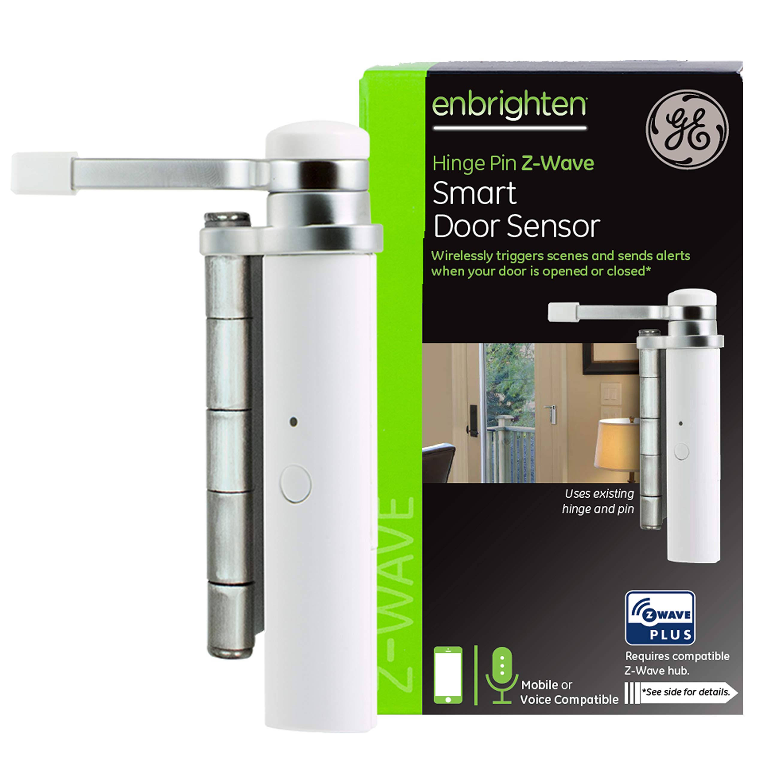

My challenge is that I have a GE Hinge Pin Sensor that worked fine with my Vera and works fine for a while with my Hubitat, but for whatever reason, after about 4 hours, a simple app that turns on a pantry switch and outlet goes from being nearly instant to taking roughly about 8 seconds. Its pretty darn consistent.
Rebooting the hub does not help. I can remove the sensor, re-add it, rebuild my app and works like a champ, again for about 4-6 hours. Everything else remains blazing fast, I have a motion detector that is so much faster than my Vera that it startles me when it fires. Additionally, there is a second automation that just turns on and off the outlet from the switch. That works consistently throughout all of this.
Not a lot of info on the hinge pin in the forums, hoping you all can point me in the right direction. I have rebuilt the network a few times. Removed and re-added all 3 nodes, checked for ghosts. Starting to wonder if this is a known issue for the Sensor and maybe that is why there is not many post about it.

If that is using a contact sensor driver, try switching to the Ring Alarm Contact Sensor Driver (the first one not the Gen2). There is a battery reporting issue that is known to cause a mesh slowdown (being addressed in the next update I believe).

May want to hit Configure and wake it up once after changing the driver to make sure the changes β€œtake” in the device.
I have one of these on my back door and one on my front door for well over a year. I use the driver called "Z-Wave Door/Window Sensor" never had any problems, although it has never reported battery level. Battery:1 is all it ever says. Also whenever the door is open/closed the logs show this:
No, big deal the device reports the open/close correctly and quickly, it would just be nice to get battery reporting.
Every z-wave device in my house is z-wave+ including the hinge pin sensors.

I'm using one of these on a outside door for about a year as well. I'm using the "Generic Z-Wave Contact Sensor" driver and have no issues. Like most of the GE Z-Wave products it was a PITA to pair but works well. Reports battery level and is fast. After a year the battery is still at 53%
Welp, it's been a solid 24 hours, i am going to consider this solved. Thanks! Off to see what I can break next.
