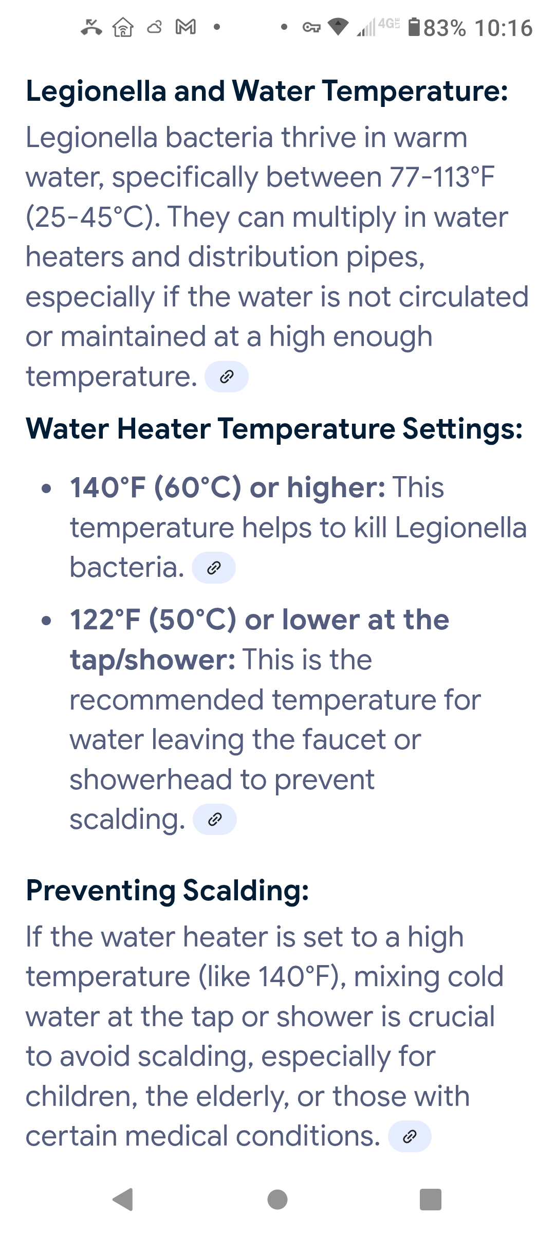

Be cautious of turning off the water heater for extended periods of time. Your water heater is a breeding ground for legionella and legionnaires disease if not maintained at the proper temperature.

The only time I turn ours off is if we are going to be gone for a few months. Then when we get back, after the water has heated back up, I'll run the showers for 5 minutes or so without anyone in them. I read that the steam is a real problem if in the shower and legionella is present
