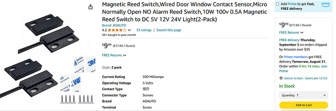

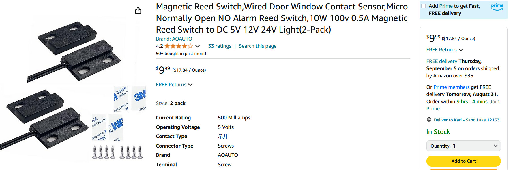

Just doing a little search this one looks pretty nice and its made to be outdoors: https://a.co/d/9RBtqJP
Wiring, it is just just two wires. This particular one actually has 3 wires so you can wire it as NC or NO (normally closed or normally open). I think you would want it wired NO, so when the magnet makes contact it reports closed. The ZEN17 can be configured to reverse it anyway so it doesnt matter a whole lot.
To clarify, this is NOT a smart device, it is just a contact sensor. But you can wire it to a smart device. If you have a power source there already and need a relay to open/close the gate then the ZEN16 or ZEN17 plus a wired sensor is your best option IMO. No batteries to deal with on the sensor that way. The ZEN17/16 can even be direct wired to a 5v DC power source.

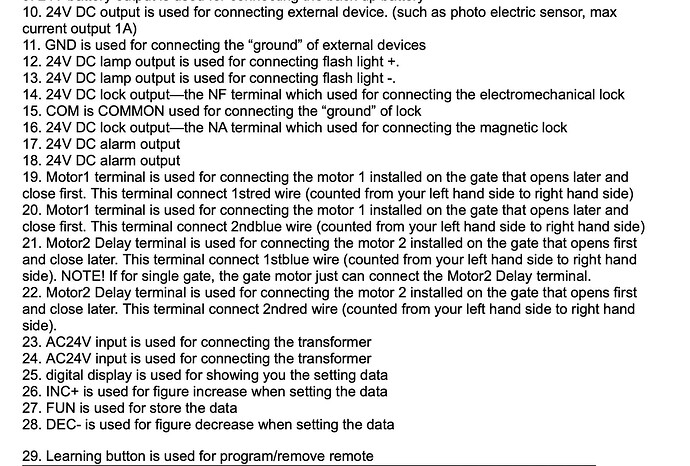

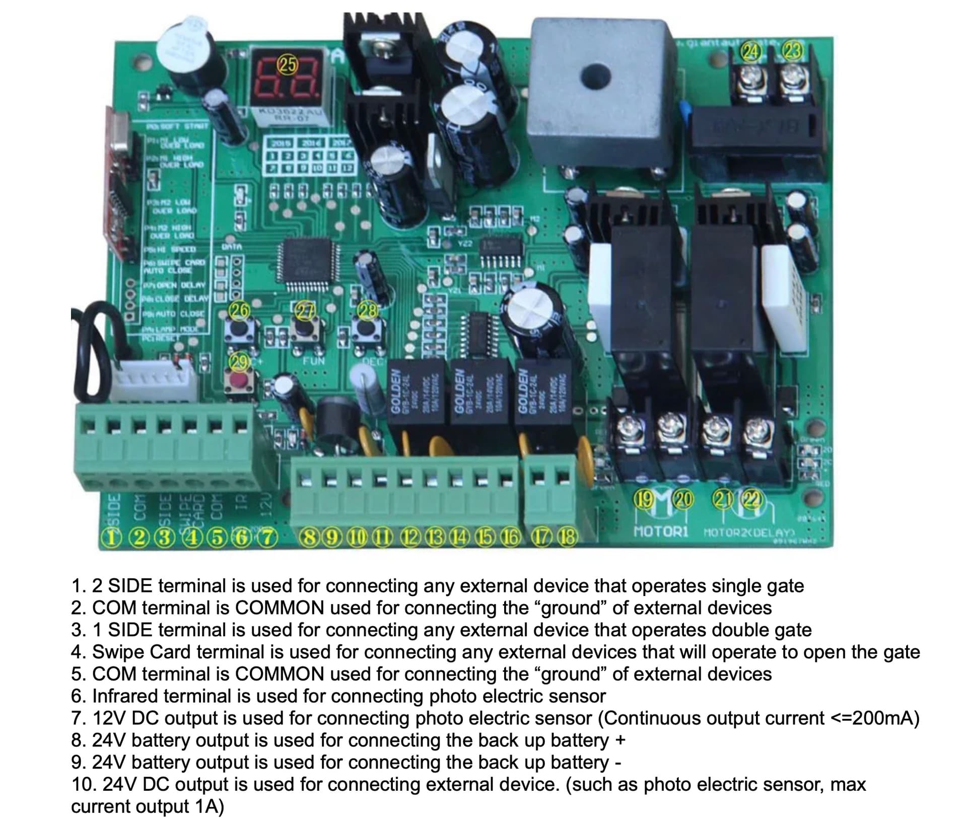

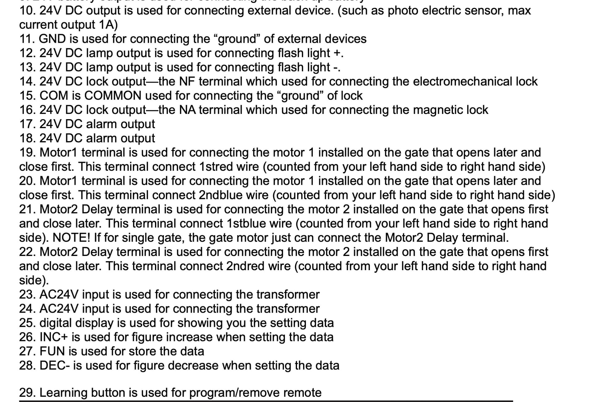

Got it all working with a cheap contact sensor. Before I order a robust outdoor reed sensor and a mag gate lock, maybe one of you guys might be able to tell me how to forego the reed sensor and use the control board to give me open/closed status. I'm not seeing a way.
