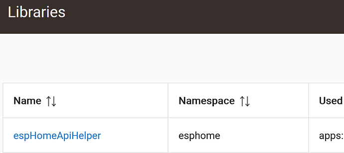

Please navigate to Libraries Code and make sure you have the espHomeAPI Helper code:
Then again I am using Adrian's version of the code and you can verify that by looking here in the driver code:
If not, open up the driver you have and click the Import button and paste in the following URL to update it:
https://raw.githubusercontent.com/ady624/hubitat-public/main/ESPHome/ESPHome-ratGDO.groovy
Then open your garage door device and click Initialize. Make sure your RATGDO has a static IP address assigned too.
