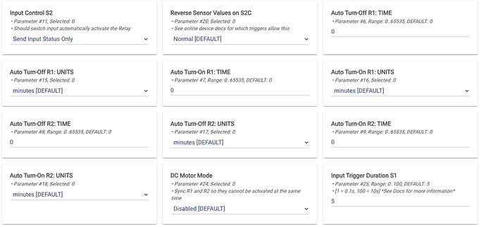

Which parameter is auto-on/off settings?
Parameter 6 and 15 for Relay 1? I think they are both off. At least they are both set to 0.
Huh, yep, that looks good to me. This is odd then... I've never had a ghost opening action on any of my various Z16/17s I've had over the years out in my detached garage, so I'm not sure what to suggest next.
