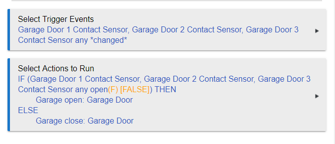

Hey there.
Perhaps I'm doing this wrong. But I wanted to ask Alex if "any" garage door was open. So the virtual switch I setup turns on or off based on a rule I set that checks if any of the three garage door switches are on:
Then I just add my single virtual switch to Alexa and am able to ask if the Garage is open or closed. I just need to know if any door is open, not really which one specifically.
Both Hubitat and Alexa is new to me. Am I missing some other functionality in Alexa or the Zooz Garage App to make this even easier?
Thanks for explaining, I missed the "any" part of your use case.
You're correct, to find out if any doors are open you need to use a virtual device and your rule that syncs it looks fine.
I thought that if you put all the garage door devices into a "garage" group in the Alexa app then you could ask if any doors were open in the garage and she'd list them, but I was thinking of Google Home and it turns out that feature only supports lights so that wouldn't have worked with Google Home either...
