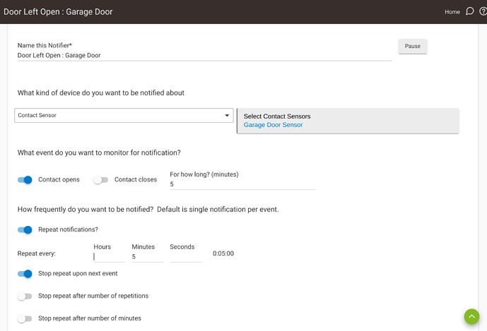

Here are the screenshots of the setup for my notofication app setup. It is a 5 min interval though so you would just need to update that.
Just to highlight an alternate approach: I use the Rule engine instead of Notifications to provide a few options that aren't available in the basic Notifications setup.
@mavrrick58 and @velvetfoot That's the exact setup I tried but I only wanted it to notify me after 9pm. If the door is already open at 9pm then it doesn't send the notification.
I couldn't figure out a way for the Notifier app to check the status rather than a contact change.
