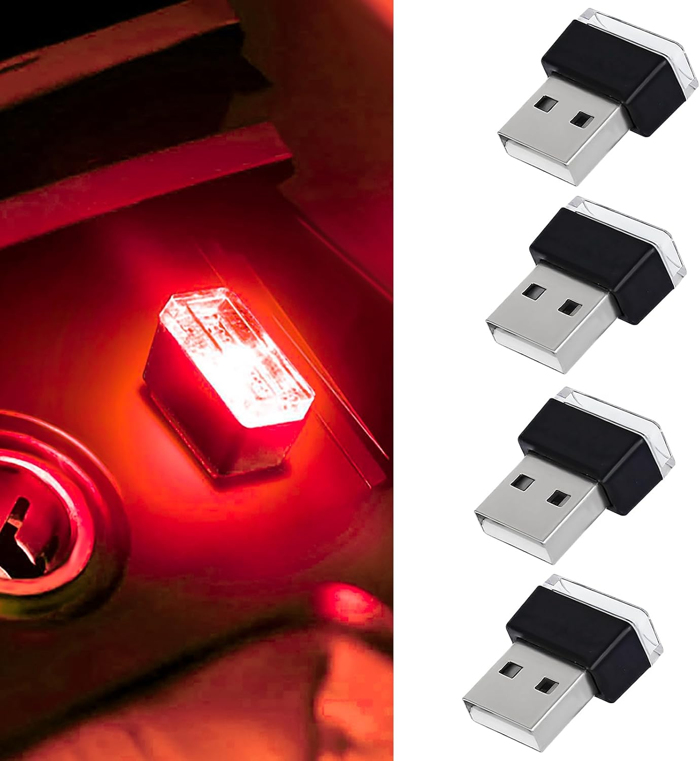

I then bought red, white, and green versions of these LEDs from Amazon (aqua, blue, and magenta are also available -- search "Hbxdeco"):

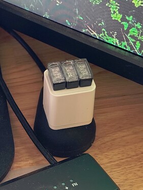

The LED's fit perfectly into the 3x USB adapter switch, and can be independently turned ON or OFF (but not flashed via a driver command). I assume that they will fit into the 2x adapter as well. One advantage of using just the 1x adapter is that the driver allows flashing. Pictures below, mounted on a USB extension cable desk stand (which is plugged into a USB power brick on the other end).

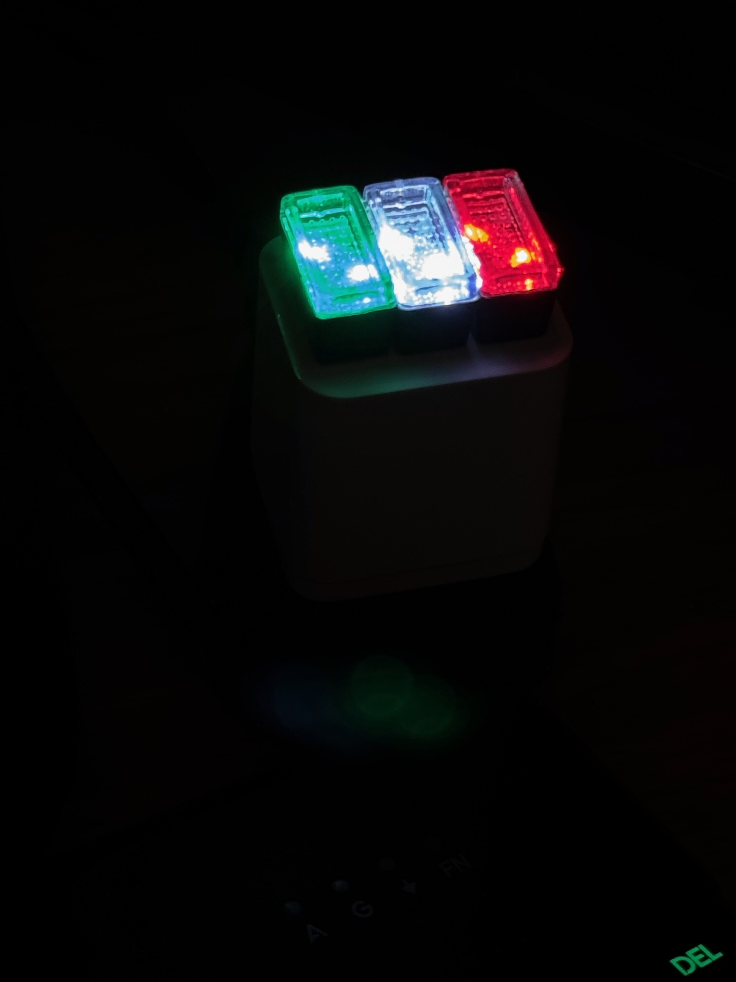

Here's a picture of them all ON:
I use them for more discrete alerts than flashing a lamp in my office.

How bright are these? Just bright enough for notifications? Or blind you if you glance at them wrong?
Just bright enough for notifications.

The LEDs appear to be these:
https://www.amazon.com/dp/B0D1FX5XFP/?th=1
Those are the LEDs on Amazon.

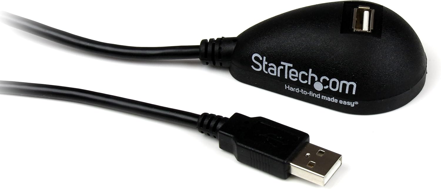

Note: if you use the single port switch (which can flash), you can put the switch at the powered end of a desk extender like this:
And then insert an LED in the desktop portion, for a lower profile desk alert light (which can flash).

I use the "Generic Zigbee Mulit-Endpoint Switch" driver, which creates 3 child devices for the 3-port USB Tuya Zigbee adapter.
Unfortunately, no "Flash" action is available for the parent or child devices.
I'm hoping someone who knows WAY more than me (not hard to do) will create a driver for the multi-port versions of these USB devices that supports flashing.
