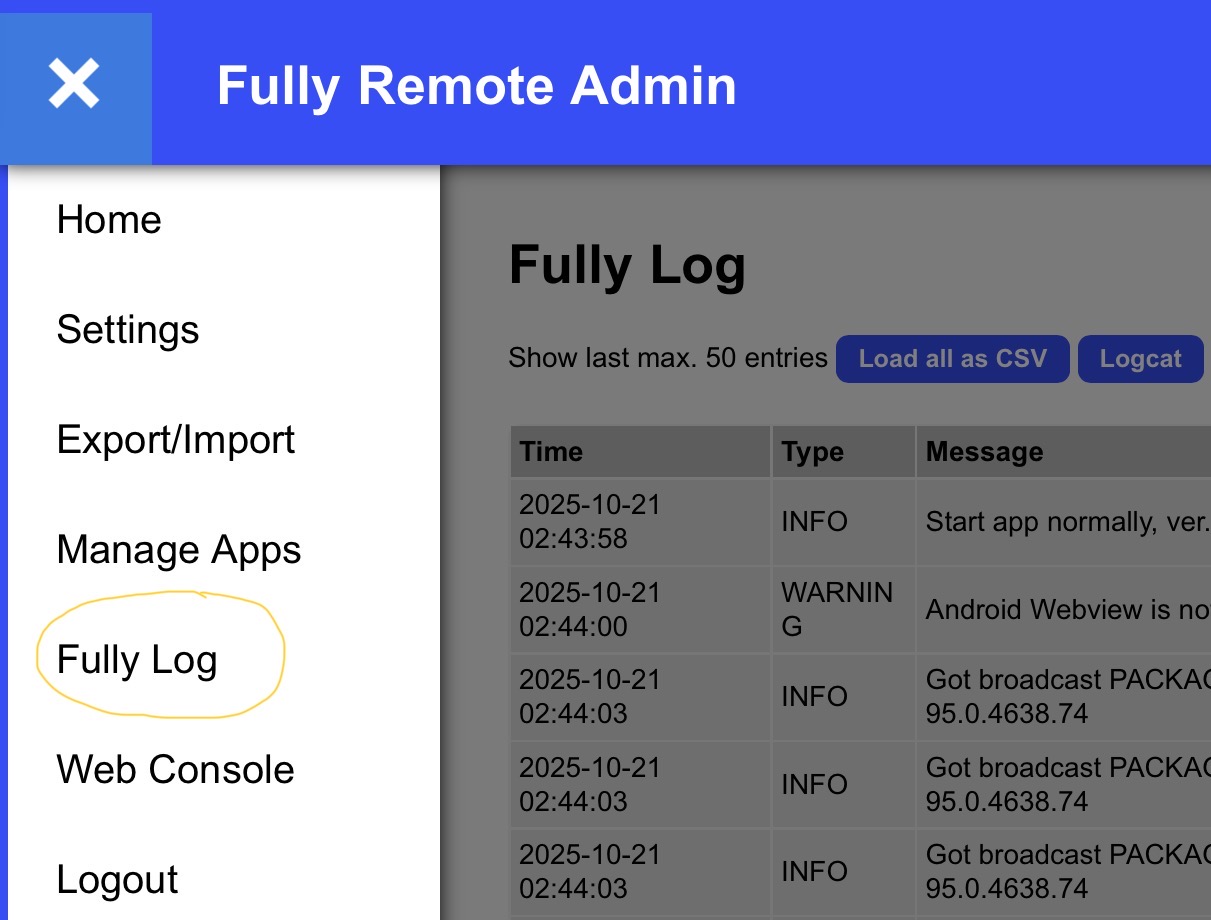

I havent been able to find any logs
Are you not paying for plus?
Considering the dashboard loads in chrome on the same device
What app is this screenshot taken from?
Its the web remote admin interface
Thanks, set the remote admin console up. No errors in the logs
the only place the dashboard url doesnt work is fully correct? Other than un/reinstalling the app, idk what to tell you.
