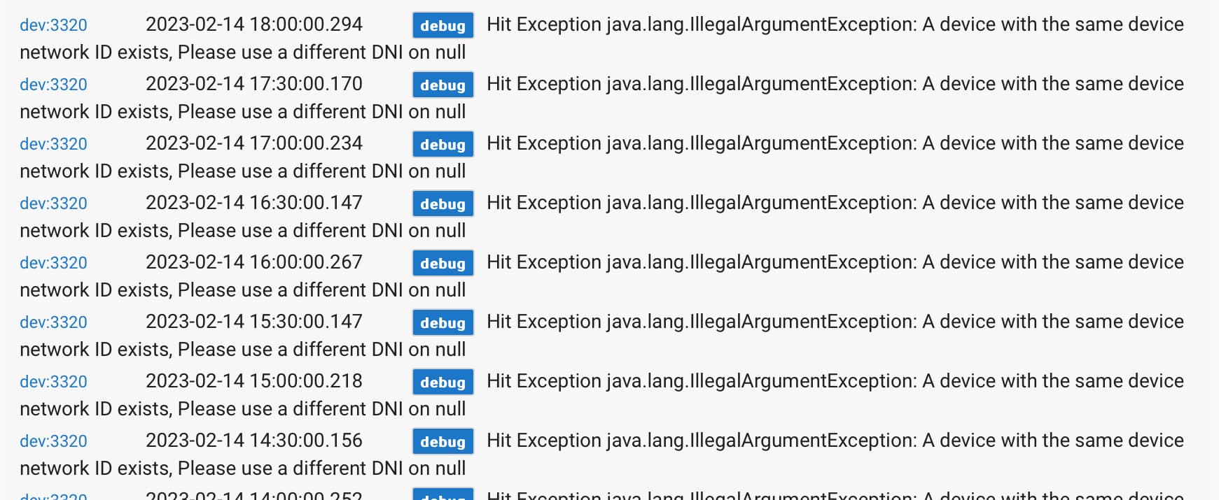

I recently got a solar array using a couple of Fronius Primo inverters. I’d love to be able to integrated them to Hubitat, but have not yet been successful. I’ve tried using the following driver, with either Inverter numbers 1 or 2; the ip is correct (i can access via web browser) and using Port number 80.
In case someone can figure this out… the code above give me the following:
On one inverter:
On the other:

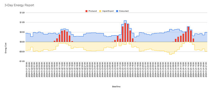

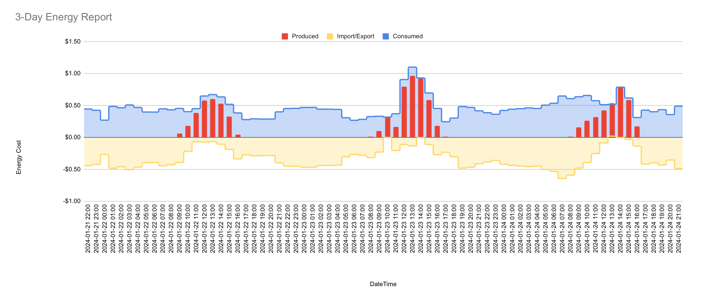

With this update, and sending the results from the fronius inverter and also my energy meter with a “Hubitat to Google Sheets” integration, I create the following graph that shows me my production and consumption for the past 3 days.
I have a couple EVs that I charge with the excess solar energy. Using Hubitat and an integration to one of my EV’s, I update the charge amperage on one of those up and down to match with the extra energy being produced.
