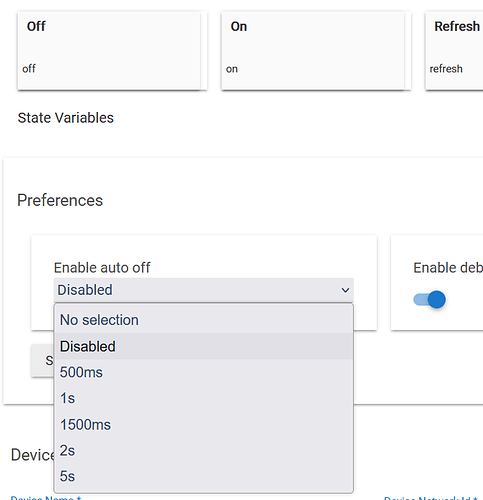

if you were willing to use the reverse logic as the trigger, (when the virtual switch turns on instead of when it turns off), then there is an auto off setting in the device itself.
Next time i will set it up that way
