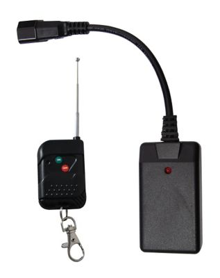

It comes with a box in the back that looks like this for the remote.

Am i correct in thinking i could wire a zwave relay into some kind of pigtail to trigger this thing from hubitat?
If the answer is yes i welcome any suggestions.
A Fingerbot would be ideal for this.
https://a.co/d/hsa6G26
I have two that work great with the driver from @kkossev
yes. if you have a multimeter, you can check the pins on the button to see which pins get connected when pressing the button, and wire a relay to this. this will function like "remote fingers" for you to remotely control the remote. i did something similar with a blinds remote before i got a bond bridge, so it definitely is possible. just be sure to not trigger both relays at the same time in case it might cause some weird things on the remote
